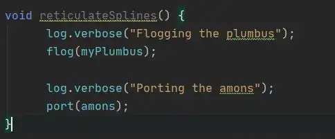

Often, log messages denote method boundaries
Note that this only applies to log messages in the style of "Doing X".
When you feel like your logic needs to be logged using multiple "doing X" messages, such as flogging the plumbus and porting the amons, that generally implies that these two tasks are separate jobs, and therefore should be abstracted into methods of their own.
This means helps keeping your actual business code from being distracted by its logging. If your subtasks are abstracted into methods of their own, and the task itself merely consists of the orchestration of its subtasks and the logging of those tasks being done, then you're going to find that the logging isn't really obfuscating the business logic anymore since you've separated them.
reticulateSplines() {
      Log.verbose("Flogging the plumbus");
      flog(myPlumbus);
      Log.verbose("Porting the amons");
      port(amons);
flog(Plumbus myPlumbus) {
    // Plumbus flogging logic
port(Amon[] amons) {
    // Amon porting logic
Note that even if you personally favor putting the "Doing X" log method inside the X method itself, which is a valid approach too, that still means your methods will only contain one of those messages, right at the top. The rest of the method body is then not being distracted by having additional log messages interspersed among its logic.
