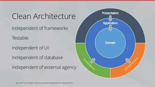

When you look at Clean Architecture diagrams, the DAL is often put on the same level as the top-level consumer (e.g. Web project) since both individually depend on the domain.
Note:
  • In this answer, the domain and application layers have been lumped into one big "domain" blob because their distinction isn't the topic at hand.
  • Persistence is the DAL. This is often just lumped into the infrastructure category in other diagrams.
  • In other similar diagrams, "entities" are part of the domain, but beware that in those cases, "entities" means "domain objects".
