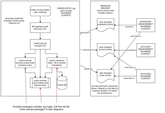

So, I want you to picture what at first seems to be a fairly "ideal" architecture according to many high-profile sources, by which I mean it hits all the right notes. We have an order entry (point of sale) system. It's a bounded context. We're not "trying too hard to be microservicey" and creating nanoservices, and we're also not a distributed monolith. It's effectively agnostic about the existence of any other system in the enterprise. It's as decoupled as it can possibly be. It has no hard temporal, logical, or availability dependencies on any other system. It looks something like this:

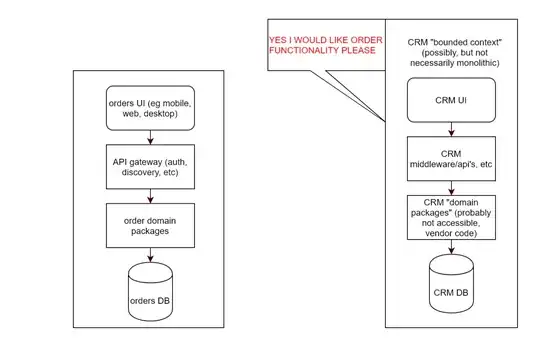

Decoupled orders bounded context application
One day the business comes along and says "I want order entry (or quoting) functionality in the CRM system".
Oh dear.

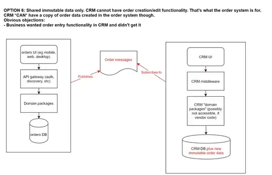

Personally, I think option 6 is the most - and perhaps only - sane choice. In a couple of places, I mention that shared library/schema definitions are "probably not a real objection". I say this because the business rules are the business rules. There's only one set of business rules for the bounded context of orders. If the business rules change, everyone using those rules has to change. This isn't a devops issue.

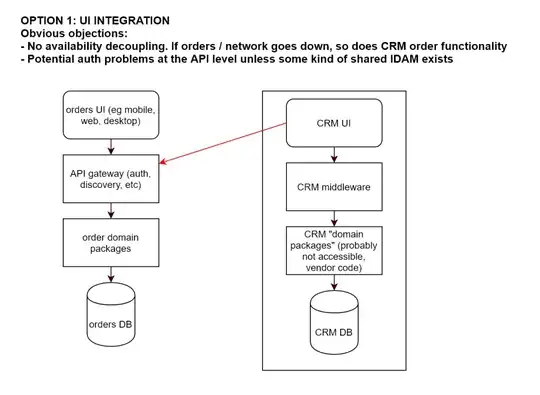

Option 1 - UI Integration

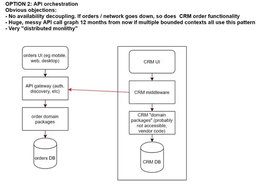

Option 2 - API Orchestration

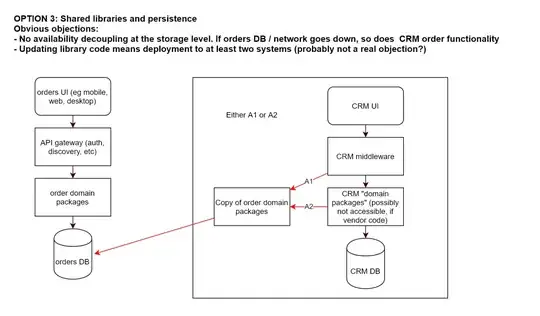

Option 3 - Shared libraries and persistence

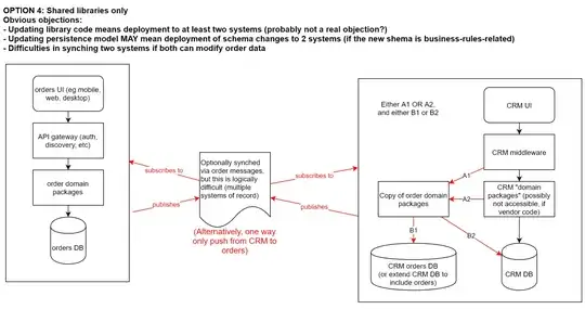

Option 4 - Shared libraries only

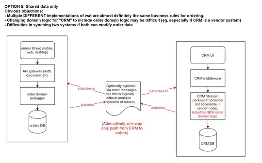

Option 5 - Shared data only
Option 6 - Shared immutable data only

    "I want order entry (or quoting) functionality in the CRM system" - one thing to consider is what they *mean* by that. E.g., do they just want a unified front-end interface to existing services (to be used as originally conceptualized)? Or are the people using the CRM system (maybe a distinct department) actually going to work with orders in a way specific to them (a way that makes it awkward & undesireable to adapt the orders system for their purposes, so that it may be beneficial to treat it as a separate bounded context in Evans' sense, with a distinct model of orders and related processes) – Filip Milovanović Jun 30 '20 at 20:53
  • Fair point. Since it's my hypothetical, I will say that they mean they want the standard order functionality available from within the CRM application. It might be more illustrative to consider it in the other direction. Suppose we are decomposing a monolithic ERP, which is currently acting as point of sale. As the first step, we just want to take the existing ordering semantics and split them off into a separate application over which we have more control, but for some time at least orders must still be translatable into to the ERP model for the sake of invoicing etc. – allmhuran Jun 30 '20 at 23:58
  • In options 1, 2 and 3 if the Orders system goes offline, would that make the entire CRM system to be unavailable as well, or would most of the CRM still work normally and only the Order-related functionality becomes unavailable? There might be better (cheaper) ways to improve the availability of the Orders system than options 4 to 6. – Bart van Ingen Schenau Jul 01 '20 at 10:19
    What exactly do you mean with one system bringing down the rest? When do you consider that a system bas been "brought down"? I think the answer to that is essential for which of your options are viable and which are not. – Bart van Ingen Schenau Jul 01 '20 at 10:28
  • I'm referring to those architectures that basically have a big nest of API calls backed by a zoo of microservices. These "separate" services end up being as tightly coupled as just about anything can be, so when one service goes down, many other services with direct dependencies on it go down, and then more go down because those went down, and so on. The canonical microservice antipattern. – allmhuran Jul 01 '20 at 12:27
  • Sorry, miissed that first question. The answer to that is "it depends on how CRM is written". So to some extent we could cross our fingers and hope that CRM has circuit breakers implemented. But hope is not a plan. Of course, even if it does have circuit breakers, it has still lost order functionality. The later models mean CRM is only ever dependent upon CRM components. The data may be eventually consistent, but the functionality remains, regardless of whether the other applications are currently healthy. This prioritises A over C in CAP. – allmhuran Jul 01 '20 at 12:28
    I think there is one additional option to consider. Keep the sites functionally isolated in all respects, and build an SSO (Single SignOn, e.g. using OAuth) from CRM to order management. – John Wu Jul 01 '20 at 21:26
  • @JohnWu Yeah, absolutely. That's pretty close to option 6. For example, if CRM is merely storing order data per option 6, then CRM users can see things like "orders by customer for the month" directly in the CRM UI without having to go to the order system (which is good), but if they want to actually create orders, they have to go to the order system to do it. It allows CRM to have a different data model for orders. Or if the CRM system already has a model of orders it wants populated (eg, its a vendor system), you can do that via transform. So 6 is functionally better than full isolation – allmhuran Jul 02 '20 at 01:20
I'd go with Option 1.
While you listed some potential downsides, you forgot to mention the upsides of this approach: Primarily keeping the loosest coupling between your CRM and Ordering domains by placing that coupling in the most volatile CRM system (the UI). This means that when the Ordering API changes only the CRM UI needs to respond. This is ideal.
I'd also like to point out that the "downside" of having the CRM ordering system fail when your Ordering domain is down doesn't really sound like a downside to me. Presumably, if your Ordering systems can't take orders... well... you probably don't want other parts of your system to be taking orders. What does the Order UI show when it's down? I'd expect the CRM UI to mirror that.
Furthermore, if we simply rearrange your architecture so that there is only one UI (instead of each service having its own) I think the solution is a little clearer. My experience with micro-services is that they tend to be more representative of your service layer than anything "above".

  • The loosest coupling of the options presented are the 3 where messages are shared between the systems. The first three all involve a direct call from one system to the other, rather than communicating through messaging. I can absolutely have other systems taking orders when the actual order processing system is down, because the other systems are simply queuing up messages. When the order system comes up, it can ingest those queued messages. The "one UI" idea is a good one if you write all of your own software, but remember, CRM might be a big vendor system, like dynamics or something. – allmhuran Jul 02 '20 at 01:15
  • @allmhuran The only options you included above where the CRM simply pushes messages onto a queue also include tight coupling to the ordering logic (either via maintaining a copy to the package or by duplicating domain logic). This means changing the Ordering domain *necessarily* requires changes to the CRM domain. There are very tightly coupled systems regardless of how messages are orchestrated. And a message queue presents similar points of failure as direct communication. Now the CRM ordering functionality could stop working even if Ordering domain is working! (we've added coupling to a MQ) – user3347715 Jul 02 '20 at 15:05
  • @allmhuran It's also possible that I am taking a wider view of what constitutes "coupling" than what is used above. I don't view "coupling" in simple terms like "lines of communication". For example, to my mind, Option 2 is more coupled than Option 1, Options 3,4,5 are an absolute disaster waiting to happen, and Option 6 is the least coupled in terms of our domains (not in absolute terms) but doesn't fulfill the use-case. – user3347715 Jul 02 '20 at 16:57
  • I don't view "coupling" in simple terms as "lines of communication" either. That's why I specifically qualified it as "availability coupling". As I said in the opening, there can also be temporal, logical, and other forms of dependencies. You'll note I didn't mention any of the advantages of any of the options, except when stating my preference. Because the point was to show that none of the options, except perhaps the last, adhere to all of the principles to which we would like to adhere. – allmhuran Jul 02 '20 at 21:52
  • @allmhuran I must have misunderstood your statement about the loosest coupling being the ones where messages are shared. – user3347715 Jul 03 '20 at 03:15
  • The loosest availability coupling is the ones where systems publish or subscribe to messages. This is why in the image headings for the first 3 options I wrote "no availability decoupling", but I did not write "no availability decoupling" for options 4 to 6. – allmhuran Jul 03 '20 at 03:35
  • Also, your suggestion to create "one UI" has ignored the point that some of these systems might be vendor systems. I even put in an explicit warning that not every business is developing all of their own software. Are you going to pay thousands of dollars licensing for a "best of breed" or "best fit" vendor system, and then throw away the UI and rebuild it yourself? No, nobody does that. – allmhuran Jul 03 '20 at 03:37
  • @allmhuran Is this architecture specifically being designed to minimize availability coupling over all other forms? I don't find availability coupling a particularly important or interesting metric in terms of a micro-service architecture. Of course you are opening yourself up to availability concerns when you put every service on it's own box! If you can't tolerate this kind of exposure, well, don't choose micro-services. A well-designed, modular monolith would fit the bill here. I fear your question is approaching, "How can I get the benefits of micro-services with none of the drawbacks?" – user3347715 Jul 03 '20 at 04:17
  • No. To be clear, I'm not trying to design a particular architecture to meet a particular need for my particular job here. I mean, yes, I do this as well, but that's not the subject I'm trying to open up for discussion. What I'm trying to point out is that the advice that exists in the field of distributed systems is somewhat incoherent. Sure, there will always be compromises. In the OP I wrote "The big question is "what do you want to achieve?". Well, let's settle on things everyone seems to agree on with distributed systems: Given CAP, we are very interested in A and P, not so much C" – allmhuran Jul 03 '20 at 04:41
  • Now, there will of course be some architectures that prioritize C over A. P is of course a given if we are building multiple different applications. But if you try to prioritize C, you *are* building a distributed monolith. As long as that's a conscious decision, OK, fair enough. But the one thread of advice that seems to exist across all expert sources is "don't do this". – allmhuran Jul 03 '20 at 04:43
  • @allmhuran Well I think you understand the problem. The CAP theorem informs us that, given P, we must choose to forego either C or A when the network goes down. So either we choose to give up A (options 1,2,3) or C (options 4,5) — Of course there is the unlisted option of giving up P and putting Ordering and the CRM on the same box (like right half of option 4). The choice depends on the goals. It’s usually much less of a headache to give up availability than consistency, but not every system can tolerate that. In my experience the “micro-service” paradigm is more suited for the former. – user3347715 Jul 03 '20 at 11:39
