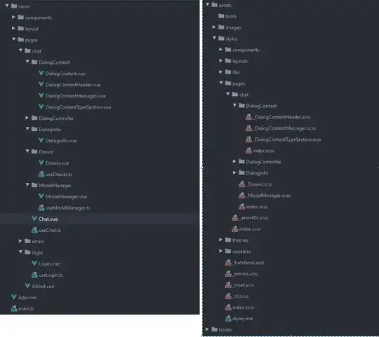

I have developed an open-source vue.js scaffold which is based on my exprience and study on various vuejs projects.
Currently it has a good structure(i think), but i'm nervous about is it good enough for a chat scaffold and the goal of this question is about where is the better place for scss files in this scaffold?
I want to know about your opinion with explanation, because i believe a good scaffold will help a lot to develop better web apps.
https://github.com/SeyyedKhandon/vuejs-persian-chat-scaffold/tree/develop
first one:
I think this is more manageable and reuse-able.

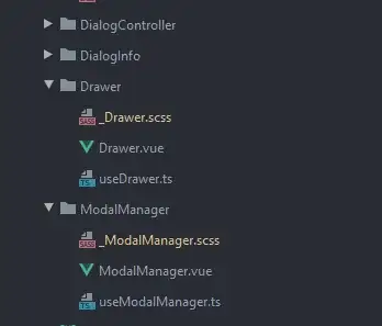

second one:
I think this will increase the speed of develop( by reduceing the time of going through other places to find the corresponding files)

    This question is likely to get closed due to opinion based answers. Either way, I'd have preferred the second approach of the two presented, i.e. the style files along the `.vue` files, effectively using the package by feature approach. – Andy Jun 09 '20 at 12:08

    I would prefer second approach so you can find relevant code of that module easly – Ishan Shah Jun 16 '20 at 08:05
I personally prefer the first one. but if page and layout are components, it can be nested inside the component folder.

  • Can you tell me why do you prefer the first one? is it more manageable? it would be very good if you explain the purpose and your experience about it. – SeyyedKhandon Jun 09 '20 at 12:43
    with this structure, I can create a really fast and ready boilerplate project and it doesn't depend on any javascript framework or library, I can look at it as a layer of my app (style layer), like persist or service layer. – hamidreza kazemi Jun 09 '20 at 14:40
  • Aha, i got the point. thank you – SeyyedKhandon Jun 09 '20 at 14:45
