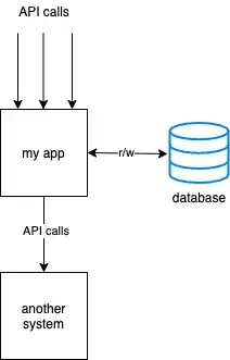

This application receives an API call (HTTP), does some internal work that usually includes reading or writing to a database that has 5 different tables, generates an XML file and then sends it to another system via a REST interface. This has around 5K lines of codes.

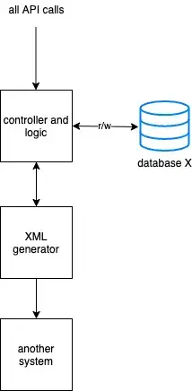

  2. Splitting the part of my app to smaller services. Here, I avoid code duplication and each service can use a different programming language, but if a single microservice is down, everything stops working. Moreover, this looks like a monolithic architecture, because I'm just separating the layer with HTTP request instead of a class/functions interface. It seems maybe a bit easier to understand and maintain, but not really giving anything more.

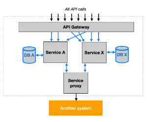

I could for example think of this one, which combines both of your approaches: migrating your common XML generator features into a "Service Proxy" (the name is arbitrary: it seemed to be a relay between your new microservices and other applications), splitting the core of the monolith into highly cohesive but loosely coupled capabilities, and hiding the details of the split to the outside world behind an API gateway:
