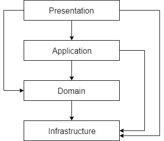

In a Layered system each layer depends on the layers beneath it. A layer should have no knowledge about any layer above it.
thinktocode.com - layered architecture
You called it UI, they called it Presentation but other than that discrepancy this diagram and that rule both allow a domain object to be understood by the highest layer.
I can tell that it's bugging you anyway. And it should. But violating Layered Architecture isn't why. No this is a different rule.
The violation here is against the Law of Demeter. I prefer to call it the Principle of Least Knowledge. It basically argues against being overly familiar with everything. Talk to your friends. Not friends of friends.
Any object that is intimately understood by layer after layer represents an easy way to break layer after layer.
The UI should have it's own data structure. One that doesn't know or care about the domain. One that a presentation layer could populate from a different data structure. If doing that sounds like a lot of extra work that's only because it is. You don't get flexibility for free.
