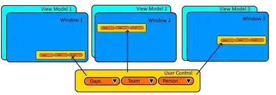

I have a UserControl in my WPF application which I want to reuse in a number of places. The control is a filtered ComboBox setup allowing users to refine their selections. My example is Department > Team > Person.
Filtered ComboBoxes being used in three different windows
In each scenario I might have the control configured in a slightly different manner. e.g. Window 1 might have all the departments, teams, and people; Window 2 might only display a subset of all departments; Window 3 might be locked to the user's department and team.
