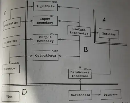

What I tried was to implement the following component diagram:
sample from the book "clean architecture"
A = Enterprise Business Rules
B = Application Business Rules
C = Interface Adapters
D = Frameworks & Drivers
But some things seem strange to me:

  1. A presenter converts the "OutputData" (with for example date objects) in "ViewModel" (that has only strings and flags). So the interface "Output Boundary" could have a function "present" with a parameter of type "OutputData" and return a value with type "ViewModel". But Output data is not allowed to have a code reference to "ViewModel", so how should this work?
No, a presenter converts an "OutputData" (with for example date objects) into a "ViewModel".
Pay attention to the little <DS> in the corners of some of these not exactly UML boxes. DS stands for Data Structure. You're not going to find any external references in the Data Structures. All arrows point to the Data Structures. None point out from them. They don't know about anything but themselves.
Yes.
No. You can't return ViewModel to the Use Case Interactor (the only thing that could have called "present") because the Use Case Interactor doesn't know what a ViewModel is.
What could happen is the Use Case Interactor could build an OutputData and then pass a reference to it through the Output Boundry to the Presentor which would use it to construct / update a ViewModel.
It's helpful to remember that the <> stuff (<I>&<DS>) can't call anything.

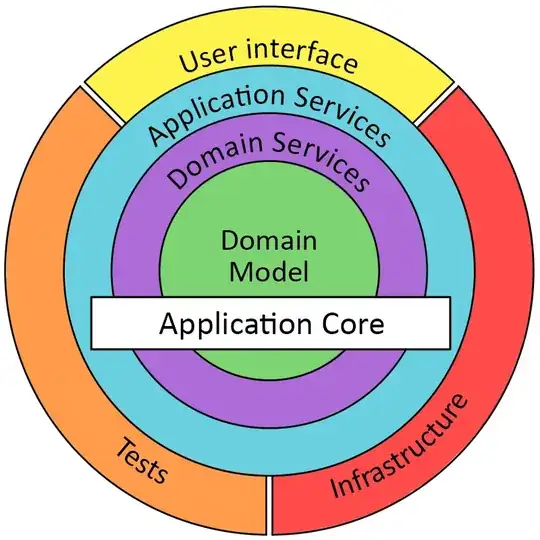

  1. He is not the only one out there having a layer called "infrastructure". But I did not find this layer in the book. Where does it come from? Sometimes people use it for database access, sometimes for services. Where does the term "infrastructure" come from?
It comes from this:
Look in the outermost lower right hand sector.
You've likely confused Clean Architecture with Onion Architecture. Same idea, different vocabulary (created to drive you to different blogs and books).
Getting them confused is an understandable mistake. Both of these are rehashes of Alistair Cockburn's idea of Hexagonal Architecture (that he's also called Ports and Adapters).
Collectively I call them The Buzzword Architectures because the main difference between them is the vocabulary that decides who gets your time and money when you learn about them.
One thing that unifies them is that they all let you create an architecture free of cycles that still manages to effectively communicate. This helps ensure a code change hits a firewall soon rather than spreading through the code base breaking component after component.
