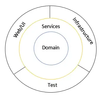

But it seems I failed to properly express my problem. I'll try once again. My application can be represented with the following diagram of Onion Architecture -
Onion Architecture with no Application Layer
Each layer is implemented as a separate project for convenience. Since Onion Architecture dictates that dependencies go only inward -
Domain - has no dependency on any other project. Defines models and interfaces.
Service - has dependency only on Domain. Contains the Service classes which implements the Service interfaces. Service classes are injected with Repository interfaces.
Infrastructure - has dependency on Domain. It defines the DbContext. It contains the Repository classes which implements the Repository interfaces. Repository classes are injected with the DbContext.
Web/UI - has dependency on Service and Domain. It contains the Controller classes which are injected with Service interfaces and/or Repository interfaces. (This project also has a dependency on Infrastructure, but that is solely for DI configuration purpose).
Onion Architecture puts persistence operations at the outer most layer as part of Infrastructure and use Dependency Inversion to access them. This results in a loosely coupled design where the Application Core (comprised of Application + Services + Domain Layer) doesn't have any dependency on data access layer/technologies.

The core argument for using repositories is to prevent leaking EF dependent code into your domain. That argument is not wrong, it just comes with a steep cost, i.e. a high-complexity uow/repo layer, which is now being regarded (by some, at least) as too high a price to pay for what it gives back.
By not using that uow/repo layer, you do actually let your domain depend on EF (the context and db sets). That much is unavoidable.
I once wrote a lengthy answer on repositories with EF. Summarizing my anti-repository conclusion: this is why it is called Entity Framework, not Entity Library. Frameworks are something you cannot reasonably abstract without effectively needing to duplicate the entire framework's structures (which negates the benefits of having said framework).
what I really don't understand is how can you get a reference of DbContext (defined in Infrastructure Layer) in Application Layer through DI
It is, in essence, no different from how you would get a reference to your self-built UOW if you had implemented an UOW/repo layer. You register your db context in your DI framework and then your service layer is able to have this context injected.
Here's a .Net Core example from one of my projects:
services.AddDbContext<MyDbContext>(options => options.UseSqlServer(connString));
It's possible to use an interface rather than the direct db context class, but I haven't really dealt with projects where that became a necessity. Use it where appropriate.
Note that this registration doesn't have to live in the top level project (as that would violate your onion layering). I actually perform this registration in my persistence project. Something along the lines of:
// In Persistence
public static class DependencyRegistration
    public static void Register(IServiceCollection services, string connString)
// In top-level Startup.cs
public void ConfigureServices(IServiceCollection services)
    Persistence.DependencyRegistration.Register(services, "myConnString");
This way, your top-level project actually doesn't need to depend on the EF dll (since it doesn't refer to anything from EF), but it still has the authority to decide the connectionstring (from its own configuration) and still directs the persistence layer to set up the necessary EF-related DI registrations.
Note: for a pure onion architecture, the top layer project should not tell persistence to register its dependencies; but rather the top layer project tells the service/application layer to do their registration, and the service/application layer tells the persistence layer to do their registration.
My example isn't full onion but I kept it for simplicity's sake. Setting up the call chain layer-by-layer isn't complicated to set up but would needlessly lengthen my example.
Other infrastructure layers like the persistence layer I define the DbContext in sit at the outside layer with the UI layer as "peer" layers.
I don't really get what they mean here. This description of persistence and UI being "peer layers" sounds like it's at odds with what an actual onion architecture should be.
For a bigger example, check out the NorthwindTraders github repository. The author of this repo also has presentations on Youtube where he elaborates on the how (and why).
