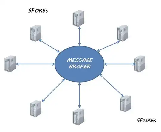

Event-driven architecture (EDA) is an architectural pattern that promotes the production, detection, consumption of, and reaction to events. They are usually broadcasted through notification messages. This explains why EDAs often leverage the messaging integration style which relies on some sort of Message Broker to implement a topology known as Hub-and-Spoke. There are many well-known examples of either on-prems or cloud-based message brokers: RabbitMQ, NATS, Kafka, IBM MQ (former MQSeries), MSMQ, Amazon SQS and SNS, Azure Service Bus, and so on and so forth.
Hub-and-Spoke topology

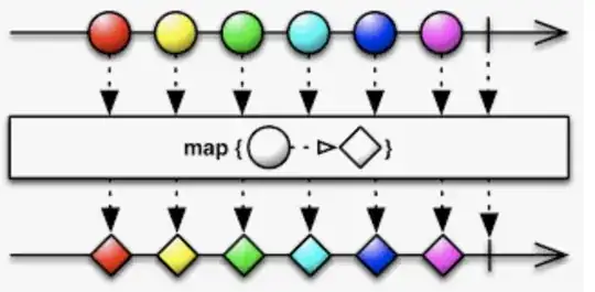

Yes, it is, although not the only one. Reactive programming is a declarative, event-driven programming paradigm concerned with data streams and the propagation of change. It is the availability of new information that drives the logic forward rather than having control flow driven by a thread-of-execution. It supports decomposing the problem into multiple discrete steps where each can be executed in an asynchronous and non-blocking fashion, and then be composed to produce a workflow — possibly unbounded in its inputs or outputs.
Marble diagram
It began to receive special attention in the mainstream when Erik Meijer, at Microsoft, created in 2011 a reactive programming framework for .NET called Reactive Extensions, a set of tools allowing imperative programming languages to operate on sequences of data (data flows) regardless of whether the data is synchronous or asynchronous. In a matter of years, Reactive Extensions (aka Rx) was ported to several languages and platforms, including JavaScript, Python, C++, Swift, and Java.
In the JVM world, Reactive Streams started as an initiative in late 2013 between engineers from Pivotal (now VMware), Netflix and Typesafe (now Lightbend).
The fundamental idea behind reactive programming is that events are data and data are events.
