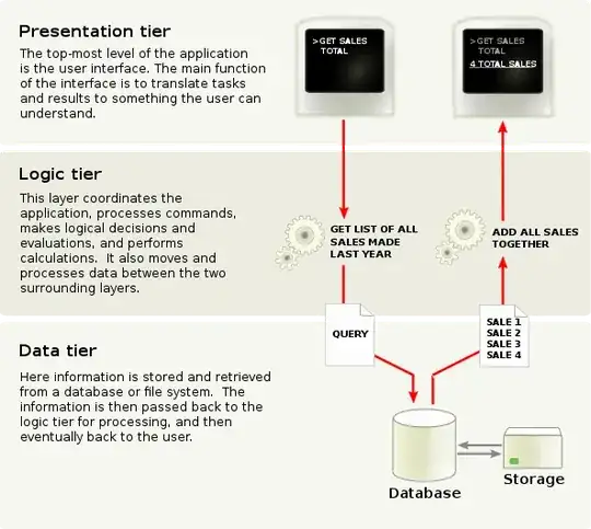

Primarily Vertical
According to Wikipedia (2020-08-09)
Middleware makes it easier for software developers to implement communication and input/output, so they can focus on the specific purpose of their application
This is quite a poor article, but it does match my own experience.
If you read the Multi-tier Architecture Wikipedia article (particularly in the simplified Three Tier section) is much more enlightening. It's better to describe middleware as the domain of software that is between the "Presentation" and "Database" layers. This is sometimes also called the "Logic" layer, the "Business" layer, "Application tier", or "Middle tier". This Middleware middleware layer is therefore fundamentally about "vertical" abstraction.
Within this Middleware layer there are many different ideas and implementations that themselves can be thought of as horizontal.
Pipeline: A horizontal implementation within the Middleware Conceptual Vertical Layer
Your "Microsoft ASP.Net Core Middleware" reference is quite specific. Node.Js ExpressJS has a similar architecture and ASP.Net Core is likely inspired by ExpressJS. Here, "Middleware" is used within the context of a server-side software and each step in the HTTP Request/Response pipeline is called "Middleware". It's sort of valid, but awkward. It's quite likely that the marketing department had a hand in that. "Middleware" is usually considered in the context of a "whole software system" as a vertical abstraction.
