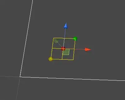

Now when i move the center point to some arbitrary world point, i get this problem:
For this image the extra tiles appear when the center point is this value ( there are other numbers that cause it):
Bounds Span : 2f by 2f
Grid Size : 1f by 1f
Center point : 3.97f , 2.7f  (the red dot)
Notice my for loop now runs one extra time some times, i have tried casting and flooring to int, both don't fix the problem, and thats because float imprecision is the cause, for example i've had 2.000000000f cast to int as 1.. so it still didn't work if i cast the result of the division because it would be off by 1 in my for loops, see here:
When casting to int i get one less tile:
But i've seen plenty of applications use grid positions based on some local reference point, there must be some trick to get this to work properly that i am not aware of with floats... does any one know?
