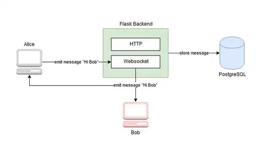

The website I am building has a real-time messaging component. The backend is built with Flask and I have integrated Flask-SocketIO to handle Websocket connections when users are on the messaging page.
My current infrastructure is pretty simple. Flask handles both HTTP requests and Websocket events. When users land on the Messages page, the client sends a GET /message_history request and then opens a socket connection.
When Alice sends a message to Bob, the server handles the event, checks that Alice is logged in and is allowed to talk to Bob, then stores the message in the database and finally emits the message back to both Alice and Bob, whose clients are listening for events from the server.

At a high-level, in your design, the PostgreSQL database is standing in for the Redis cache and/or messaging system.
This can be made to work but you could run into scalability issues. When you use a database as a messaging system, managing the state of messages becomes problematic. For example, when you create a new message to be sent, you want to make sure that only one handler picks up that message and delivers it. This coordination is not something that DBs tend to provide by default. There are various schemes you can use but if you use a messaging platform it's an inherent feature.
