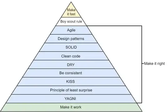

I really like this Medium article that presents the following pyramid:
The idea behind the pyramid is that you shouldn’t undermine the lower layers at the expense of higher layers.
First of all, do not think this image is absolute. It should not be followed blindly. But it basically states that it is reasonable for some principles to be more important than others - and perhaps, getting your solution working should be the highest priority.
In the lenses of your SRP vs YAGNI question, I would ask myself:
  • Is your solution currently working? Or are you trying to improve it before getting the right functionality right?
  • Will SRP make your code better? Aren't you overengineering/generalizing something too early?

    I don't think the right way of dealing with the mentioned principles is just sorting them in some more or less arbitrary way and then looking which of them "stands above the other". What helps is to gather some years of real-world software development experience in different contexts so one can judge when to prefer which one over the other (if they are really have opposing goals, which is often not the case). So I agree to your bottom line, but I would be careful with that pyramid. – Doc Brown Nov 29 '19 at 17:55
    I agree with you. Sorting the principles is a north. Definitely to be taken with a grain of salt. It would be amazing if we had a fast way of getting real world experience. So, to compensate and to try to propagate knowledge, we write principles and practices to generalize situations. Specifically, that pyramid helped me prioritize working solutions before starting abstracting/cleaning code (aka overengineering), which IMO is a trend of people that get introduced to software engineering principles. Because of that, I felt it could be useful as a north for the author. – ianmandarini Nov 29 '19 at 18:16
