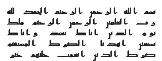

I figured it out. Took me all day but got the alignment pretty decent for that.
What I did was convert a font to SVG, manually copy-paste out the glyphs into JavaScript. Import each one individually into Illustrator, export with alignment in right place (and Illustrator export produces completely different SVG paths than what you provide somehow). Take the Illustrator export put it into this lifesaving SVG path editor; convert each path to absolute coordinates. If the SVG for the glyph looked like it would horizontally stretch easily, I stretched it in Illustrator, exported again, pasted into SVG path editor, and got absolute coordinates for that. Compared coordinates of stretched and unstretched SVG paths to find the moving parts, and converted the JavaScript SVG glyph into a template string with the variable parts parameterized by a scale factor.
That got me to the point of having scalable glyphs. Then I just sized the characters without stretching up to the point where the next word would go over the line, then took all the stretchable characters within that line and stretched them in random order to fill the space. Tons could be done here to optimize the design and placement of each stretched glyph, but that would take a lot of time to figure out probably, a research paper in itself.
I went through and added some slight adjustments for different characters so they merged appropriately without awkward gaps, but overall I didn't have to do too much tinkering with the glyphs themselves. They still don't look perfect but it's good enough for a first draft.
If I had more time I would design my own font and make sure all the glyphs can blend together nicely.
What I learned was that in Arabic script, in the browser, you are dealing with statically sized vector paths like with SVG (like with any other font, English, Hebrew, Chinese, etc.). The SVG was marked with "initial", "medial", "final", etc. on the glyphs, so somehow the font engines are looking for these specific features for this specific language. I didn't need to look for this, but I still don't know how it works. But basically, you just check if it's isolated/initial/medial/final and pick the glyph from that set, or fallback to isolated. The glyphs don't magically glue together like drops of water, they are just aligned properly in the fontfile (or SVG) so given the right letter spacing they will seem to "merge". It's just static glyphs, nothing fancy.

    Kudos for the effort and result! – marstato Nov 11 '19 at 09:24
  • How did you evaluate that the result was "pretty decent"? Are you a reader of Arabic? Did you have a native reader evaluate? Or someone expert in Arabic orthography? The advantage of using system libraries is that there's a chance they have benefited from this kind of evaluation. – Jim DeLaHunt Nov 11 '19 at 09:54
  • I am just going by (a) what looks pleasing for someone interested in learning to read Arabic, and (b) the best ancient documents (again, which have that pleasing UX), like [this](https://artlogic-res.cloudinary.com/w_2000,h_2000,c_limit,f_auto,fl_lossy,q_auto:good/ws-samfogg/usr/images/artworks/main_image_transparent/items/11/11c0279b4fc249339816d38f75e97369/17643.png). – Lance Nov 11 '19 at 12:57
