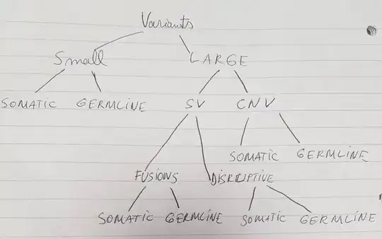

Currently I have a large ontology like this: enter image description here
There are different categories of variants and each can be somatic or germline. There are more common behaviours between same variants, like somatic CNVs and germline CNVs have more common behaviours due to the fact that they are both CNVs. But there also are a few behaviours common between small somatic and somatic fusions due to them being somatic (this design doesn't account for that kind on reuse).

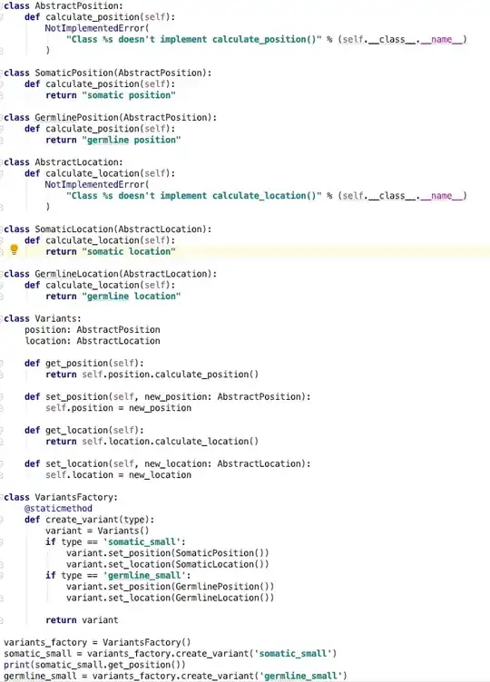

So I'm thinking of changing it to something else, a strategy pattern with a factory, like this: enter image description here
But this runs into the issue that I have too many behaviours and they are quite specific to a class of variant. Example of behaviours:
  • calculate_position()
  • calculate_gene_location()
  • calculate_log2foldchange()
All these do something different depending on variant type. And they are quite short functions. So I'll end up creating a lot of small behaviour classes and end up with a more extensive ontology.
Not all variants have the same behaviours: some have a protein_prediction() or split_reads(). At the end of the day I want to be able to get 8 classes with the behaviours that I need.
Any ideas of a better way to organise my code?

    One way to go about it is to create the 8 classes independently first, then write some client code, examine how these classes are actually used there; and if you identify some truly common behaviors, or if there's a way to generalize (from the perspective of the client) some group of related behaviors, extract those into a separate class. – Filip Milovanović Oct 18 '19 at 14:41

  • inheritance with specific overrides for specific variants. This might result in a deeply nested class hierarchy and some redundant code, looking at redundant characteristics in the ontology. Here, the decorator pattern could help to add behavior that is not common to all kind of variants. The advantage is that behaviors have full access to all the variant's attributes.
  • composition, delegating some behavior to specific component. If several components define together the behavior, multiple dispatch could be considered. This works very well if all atributes of the behavior can be migrated to the component. If behavior is only influenced marginally by some components, the template method pattern combined with delegation could be a better option.
  • composing behavior. The strategy pattern belongs to this category. If works well if parts of behavior can be encapsulated. You may also use the entity component systems approach. It is popular in the game industry, since it allows to keep class hierarchies flat and avoid combinatorial explosion.
  • any combination thereof.
