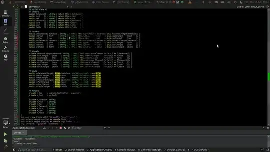

For those interested, this is what I ended up implementing as my basic class structure
    /* Boiler Plate */
    // Getters
    public table() : string { return this.m_Table; }
    // Setters
    public setTable(table: string) { this.m_Table = table; this.tableChanged(table); }
    // Signals
    private tableChanged(table: string): void {this.onTableChanged.forEach(f=>f(table));}
    // Slots
    public onTableChanged: Array<(table: string) => void> = new Array;
    // Member variables
    private m_Table: string;
let psql = new QPostgreSQL( "db_qpoll", "/*/*/*/*/*][/" );
psql.onTableChanged.push((s) => console.log(s); ); // You can toss functions in here.
psql.setTable( '"Question"."Questions"' );
or in picture form : enter image description here
The only thing I wish I had now, are text preprocessor macros to simplify everything here.
