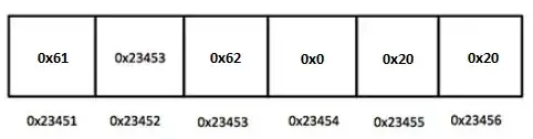

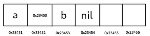

Recently I've been trying to explain pointers in a visual way, as flashcards.
Question 001: This is the drawing of a location in computer memory. Is it true that its address is 0x23452? Why?
Answer: Yes, because 0x23452 describes where the computer can find this location.
Question 002: Is it true that the character b is stored inside the memory location 0x23452? Why?
Answer: No, because the character a is actually stored inside it.
Question 003: Is it true that a pointer is stored inside the memory location 0x23452? Why?
Answer: Yes, because the address of memory location 0x34501 is stored inside it.
Question 004: Is it true that a pointer is stored inside the memory location 0x23452? Why?
Answer: Yes, because the address of another memory location is stored inside it.
Now for the part that has got me worried. A software engineer explained pointers to me like this:
A pointer is a variable whose value is the memory address of another variable.
Based on the four flashcards I've shown you all, I'd define pointers in a slightly different way:
A pointer is a memory location whose value is the memory address of another memory location.
Is it safe to say that a variable is the same thing as a memory location?
If not, then who's right? What's the difference between a variable and a memory location?

    There's an implicit assumption here that everyone reading those pictures will know your intent that the hexadecimal number under the box is a memory address, and that the `a`, `0x23453`. `nil` etc. stuff inside them are the values. That might seem obvious to you, but I wouldn't be comfortable giving decisive answers to those questions without seeing how those fields are defined. There's really no way of knowing if `a` in the second image is a character, a string (if they're any different), or the name of a variable. If it is a string, then is `nil` also a string? Or a "null" value? – ilkkachu Aug 29 '19 at 11:54
  • 39
    Question 1 is a bad question. That is something that you need to tell the readers before they can answer the other questions. Instead of a question, it should be information given to the reader: "In the following questions, the boxes are memory locations and the hex numbers underneath are their addresses". – 17 of 26 Aug 29 '19 at 12:15
    The software engineer was wrong if these were their literal words. It should be "A pointer is a value that is a memory location". A pointer itself can be variable or constant and it can be stored in memory (where it will have a memory location) or in a register (where it will not have a memory location) – Erwin Bolwidt Aug 29 '19 at 12:18
    Question 3 is impossible to answer given the context. There is no way to tell at the byte level how the value stored in memory is being interpreted/used at the application level. – 17 of 26 Aug 29 '19 at 12:19
    Worth noting: everything you're writing here is true for C or C++ but false for basically any language that doesn't have explicit pointer referencing/dereferencing. The whole metaphor of variables being slots that values get put into breaks down for a language (like Python, or Java, or C#, or Ruby, or JavaScript, or many others) where assignment just makes a variable point to an object without copying it, and mutations to the object are visible through all variables pointing to it. Python's documentation uses the alternative metaphor of variables as nametags hanging on objects for this reason. – Mark Amery Aug 29 '19 at 12:24
    What's the difference between a box, and its location on a shelf in the warehouse? That's the difference between a variable and memory location. – Greg Burghardt Aug 29 '19 at 12:59
    @MarkAmery I'm not sure I follow. In Java, ["The reference values (often just references) are pointers to these objects, and a special null reference, which refers to no object."](https://docs.oracle.com/javase/specs/jls/se8/html/jls-4.html#jls-4.3.1) Fundamentally, object references *are* addresses. You can't say how many levels of indirection there are but I fail to see how that doesn't fit into the framework of the question. – JimmyJames Aug 29 '19 at 14:29
    @progner You're glossing over the types. `'a'` is encoded in ascii as byte with value `0b0110001` in binary (`0x61` in hex, `96` in decimal). Looking at a byte containing `0b0110001`, can we conclude that encodes an ascii `'a'`? No. Because it might just as well be storing an integer 96, or a pointer to memory location `0x61`. The semantics of the content of a byte of memory is not just dependant on the raw values of the bits, *but the way you interpret it in your system*. This surfaces in programming as different data types. – Alexander Aug 29 '19 at 17:11
    @progner Consider for example C++'s `reinterpret_cast`, and its analogues in other languages. It converts a value from having one type, to a new type. But in the process, the value of the memory cells *does not change*, but merely the interpretive framework under which those bytes are understood. – Alexander Aug 29 '19 at 17:13
    Not that this isn't relevant here, but just so you know, there is also the [Computer Science Educators Stack Exchange](https://cseducators.stackexchange.com/). – JoL Aug 29 '19 at 20:12
    I'm guessing you need some feedback to access if the students have understood the basic concepts of the lecture. You don't need to rely on tricky formal definitions (with applicability possibly limited to a specific language). If they ever had math, they understand what a variable is. They also understand the concept of pointers, because they use them all the time (phone numbers, street addresses, Instagram handles - all these point to something else). Leverage that intuition. Then just devise & draw some scenario (e.g. here a pointer to adr of x is stored), and ask them what val to fill in. – Filip Milovanović Aug 29 '19 at 20:17
    BTW, and forgive me if you already understand this, but it looks like this may be a point of confusion - this "0x23452" notation is just a way to denote a number in hexadecimal format, and it's just done for convenience. But it's just a number - in no way does the 0x prefix denote that it's a pointer, what's stored in memory is literally just a meaningless number (you could label memory locations with plain decimal integers). The meaning (i.e., how the number should be interpreted) comes from the language - the type of the variable & the way it is used. – Filip Milovanović Aug 29 '19 at 20:26
  • In addition to "memory location" you also need "number of bytes". These flashcards seem to consider pointers equivalent to characters which isn't true in number of bytes. – Thorbjørn Ravn Andersen Aug 30 '19 at 07:27
    I think in C any operation that yields a pointer that does not point to an actual variable invokes undefined behavior. Assuming you're teaching pointers as they are defined in C, it's likely that the other engineer's definition is the correct one. – Theodoros Chatzigiannakis Aug 30 '19 at 14:05
    @MarkAmery it’s also false for assembly/machine languages - a variable doesn’t have an address if it’s stored in a register – Jacob Krall Aug 30 '19 at 17:15
    There is a pedagogical assumption in these flashcards that probably ought to be spelled out -- that the symbol used to represent a value determines its type. "Type" is another of those "logical" or "formal" constructs, like "variable", that are not at the "physical" level of machine memory. E.g. you're assuming that all hexadecimally-expressed values are "pointers". – Jeff Y Aug 30 '19 at 20:03
  • @TheodorosChatzigiannakis: An object that occupies N bytes has N+1 addresses associated with it, one of which immediately follows the last byte but need not identify any actual storage. The Standard explicitly acknowledges the possibility that a pointer to the address that immediately follows one array may coincidentally compare equal to a pointer to an unrelated one, though clang and gcc are unable to handle such things reliably without causing data corruption. – supercat Aug 31 '19 at 16:55
  • The difference between a variable and a memory location (address) is that **a variable is a symbol for a memory location.** In most languages (including C), that variable also contains some *type information,* i.e. it describes *what is stored* at that memory location. The phrase *"a pointer is a variable whose value is the memory address of another variable"* is accurate; "pointer" is part of the variable's *type.* Without that type information, who knows what is stored at that memory location? It could be anything. – Robert Harvey Aug 31 '19 at 17:04
We cannot say fore sure.  Just because there is a value there that would work as an address, doesn't mean it is that address, it could be the integer (decimal) ‭144466‬, instead.  We cannot make assumptions on the interpretation of values merely based on how they appear numerically.
This is indeed an odd question.  They expect some assumptions based on the boxes, however, let's note that the addresses increase by 1 for each box.  In any modern computer, that would mean that each box can hold a byte — byte addressability has been the norm for decades now.  However a byte is only 8-bits and can range from 0 to 255 (for unsigned values); yet they show a much larger value stored within one of these addresses, so very suspicious.  (This could work if this were a word addressed machine, but it doesn't say that, and, few machines today are, though some educational machines are so.)
No. Variable and memory location are two abstractions at two different abstraction levels. Variable and pointers are higher level concept at the code/language level, memory location is a lower level concept at the machine level. Once a code had been compiled into an executable, there's no longer any variables. Trying to talk about memory location and variables in this manner is a categorical error.
A variable may be implemented using the memory, but not always as a compiler can optimise a calculation and do all calculations relating to a variable entirely in registers, or it can put a single variable to multiple memory locations, or it can use a single memory location for multiple variables.
This series of flashcard is so confused, they're not just not right, but they're not even wrong.

Let me focus on your actual question - "who's right?" when comparing these two statements:
  • A pointer is a variable whose value is the memory address of another variable
  • A pointer is a memory location whose value is the memory address of another memory location.
The answer to this is none. The first one talks of a "memory address of another variable", but variables do not necessarily have memory adresses, as the other answers already explained. The second one says "a pointer is a memory location", but a pointer is literally just a number, which may be stored in a variable, but as before, a variable does not necessarily have a memory address.
Some examples for more precise statements:
  • "A pointer is a number representing the memory address of a memory location", or
  • "A pointer variable is a variable whose value is the memory address of a memory location."
  • "A memory adress can hold a pointer representing the memory address of a memory location."
Note sometimes the term "pointer" is used as a shortcut for "pointer variable", which is ok as long as it does not lead to confusion.

The statement A pointer is a variable whose value is the memory address of another variable is oversimplified. But by the time a reader understands what exactly a memory location is, and how it differs from a variable, they will already understand what exactly a pointer is and therefore no longer need to rely on this inaccurate explanation.
The statement A pointer is a memory location whose value is the memory address of another memory location is wrong. The value of a pointer does not need to be stored in a memory location, and it's debatable if a pointer needs to point to a memory location, depending on the intended definition of "memory".
A memory location is one of multiple possible places where data can be stored. That data can be a variable, or part of a variable. Variables are a way of labeling data.

It sounds as though the question is aimed at a popular language formed by augmenting the C Standard with the additional guarantee "In cases where some parts of the Standard or an implementation's documentation describe the behavior of some action, and some other part categorizes it as undefined, the former part dominates.", as well as a definition of "variable" consistent with other languages' use of the term.
In that language, each memory location can be viewed as a numbered mailbox that always holds some number (typically eight) of bits, each of which can independently be zero or one. Memory locations are typically organized in rows of two, four, or eight. and some operations process on multiple consecutive memory locations at once. Depending upon the machine, some operations that that operate on groups of two, four, or eight memory locations may be limited to operating on locations within a single row. Further, while some machines may have a single room of consecutively-numbered mailboxes, others may have multiple disjoint groups of numbered mailboxes.
A variable identifies a range of memory locations that are associated exclusively with it, and a type as which those memory locations should be interpreted. Reading a variable will cause the bits within its associated storage locations to be interpreted in a manner appropriate to the variable's type, and writing a variable will cause the associated bits to be set in a manner appropriate to its type and value.
An address encapsulates whatever information is necessary to identify a mailbox. This may be stored as a simple number, or as some kind of group designator along with the number of a mailbox within that group.
Applying the & operator to a variable will yield a pointer that encapsulates the address and type thereof. Applying the unary * or [] operator to a pointer will cause the bits of mailboxes starting at encapsulated address to be interpreted or set in a manner appropriate to the encapsulated type.

I'm coming late to this party but I can't resist putting my 2 cents in.
At these times, what is the difference between the values stored in these memory locations?
Time 1
Time 2
Correct answer: nothing. They are all identical values being presented with different interpretations of their meaning.
How do I know that? Because I'm the one who made this up. You don't really know that yet.
You are running into something I call the out of band problem. How to correctly interpret the meaning of these values is not stored here. That knowledge is stored elsewhere. Yet when you present these values on paper you put in that interpretation. That means you've added information that simply doesn't exist in these memory locations.
For example, the values here are identical, but you only know that to be true if you are correct when you assume an ASCII / UTF-8 character encoding is how I got the first one, rather than say EBCDIC. And you also must assume that the second one is hexadecimal expressions of the numerical values stored at those memory locations, that could all be pointers to other addresses, rather than say references to strings that all happen to start with "0x". :P
Nothing stored in these memory locations tells you any of those assumptions are correct. That information can be stored. But it would be stored elsewhere.
This is the presentation problem. You can't express any number at all without first agreeing on how to present it. You can lean on assumptions, conventions, and context but if you scratch at it deeply, when the presentation isn't explicitly defined, the only truly correct answer is "not enough information".
