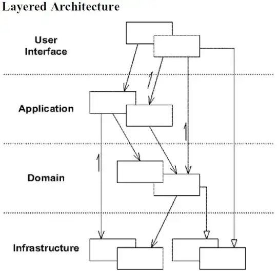

According to dddsample you can have a Repository as interface(CargoRepository) in domain layer and actual implementation(CargoRepositoryHibernate) in Infrastructure layer.
Layered Architecture picture (also from DDD blue book):
