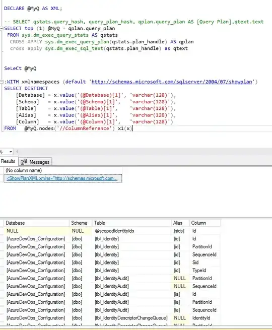

  • you can query the query plan cache and join them with the executed queries to see columns being used. Store these values in a table and link them to the credentials used to query the DDL – Walter Vehoeven Sep 11 '19 at 11:06

Have a look at the query plan cache, you can collect the column usage and match that with the credentials used to login.

Have a look at the sample that you could use in your servers
You can collect and Aggregate this from a SP_WHO2 type of query that you trigger periodically or use a server scoped trigger. Please note that you can get quite a bit of information from the user using user_name(), suser_sname() and HOST_NAME() and the above mentioned APP_NAME() to get the name of the application connecting, this is free text specified in the connection string
