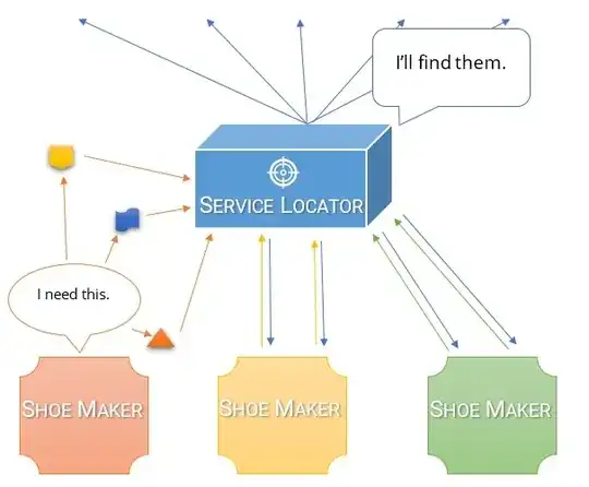

Imagine you are a worker in a factory that makes shoes.
You are responsible for assembling the shoes and so you'll need a lot of things in order to do that.
  • Leather
  • Measuring tape
  • Glue
  • Nails
  • Hammer
  • Scissors
  • Shoe laces
And so on.
You're at work in the factory and you're ready to start. You have list of instructions on how to proceed, but you don't have any of the materials or tools yet.
A Service Locator is like a Foreman that can help you get what you need.
You ask the Service Locator every time you need something, and they go off to find it for you. The Service Locator has been told ahead of time about what you're likely to ask for and how to find it.
You'd better hope that you don't ask for something unexpected though. If the Locator hasn't been informed ahead of time about a particular tool or material, they won't be able to get it for you, and they will just shrug at you.
service locator

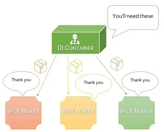

A Dependency Injection (DI) Container is like a big box that gets filled with everything that everyone needs at the start of the day.
As the factory starts up, the Big Boss known as the Composition Root grabs the container and hands out everything to the Line Managers.
The Line Managers now have what they need to conduct their duties for the day. They take what they have and pass what is needed to their subordinates.
This process continues, with dependencies trickling down the line of production. Eventually a container of materials and tools shows up for your Foreman.
Your Foreman now distributes exactly what you need to you and other workers, without you even asking for them.
Basically, as soon as you show up for work, everything you need is already there in a box waiting for you. You didn't need to know anything about how to get them.
dependency injection container

    This is an excellent description of what each of those 2 things are, super good-looking diagrams too! But this does not answer the question of "Why choose one over the other"? – Matthieu M. Apr 23 '19 at 07:49
    "You'd better hope that you don't ask for something unexpected though. If the Locator hasn't been informed ahead of time about a particular tool or material" But that also can be true of a DI container. – Kenneth K. Apr 23 '19 at 14:28
    By that logic, is Guice actually a service locator? Or does this depend on how it is used? Is annotating fields with @Inject more like asking a service locator for them, or is it more like the DI example? – kutschkem Apr 23 '19 at 15:12
  • @KennethK. There is a slight difference, with DI at the least you need to use existing interfaces and you can ensure you find out at object creation if something cannot be injected (unless you use attribute injection), with a service locator (depending on implementation) you can ask for anything (in the better cases at least it may need to be a known class and not just a string representing a class name...), but you could find out at any moment after creation that what you need is not really there. – Frank Hopkins Apr 24 '19 at 02:51
  • @KennethK. though both can be "twisted" to be more like the other, e.g. you can by convention use the service locator only in the constructor to initialize some attributes and you can use field injection and then run into null pointers later on, but if you follow "normal practices" and the general concept of DI vs. that of a Service Locator, you shouldn't run into that problem with DI, whereas you more easily can with a locator. – Frank Hopkins Apr 24 '19 at 02:53
    @FrankHopkins If you omit registering a interface/class with your DI container, then your code will still compile, and it will promptly fail at runtime. – Kenneth K. Apr 24 '19 at 04:02
  • @KennethK. which fits exactly what I said ;) – Frank Hopkins Apr 24 '19 at 08:58
    Both are equally likely to fail, depending on how they are set up. But with a DI container, you're more likely to bump into an issue sooner, when class X is constructed, rather than later, when class X actually needs that one dependency. It's arguably better, because it's easier to run into the issue, find it and solve it. I do agree with Kenneth though, that the answer suggests this issue exists for service locators only, which is definitely not the case. – GolezTrol Apr 24 '19 at 12:59
