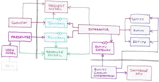

Looks like Report depends on Result right? Yeah but so what? Who said Result was concrete? Report doesn't use new on Result. For all Report knows Result is a keyword interface. Report might be a composition containing many objects. We don't know. That not knowing is what you need to preserve. That not knowing is what makes Result an abstraction. You don't have to give everything a keyword interface to do that. Do that when you need to do that.
If your programmer tries to invoke SOILD as an excuse for this let me show you a little something from Mr Martin himself:
Note that the models have no interfaces on them at all. That doesn't mean the models will never change. Just preserve the ability to add interfaces later and there's no need to add them now.
The interfaces you do see here are protecting clients from knowing exactly what behavior they depend on across a boundary that is likely to see independent changes. The models have no behavior so the boundary isn't as important to them.

    I first thought you are showing the diagram "ironically", you know, to say: The guy who came up with SOLID also came up with this mess, so let's take these things with a large grain of salt. But then I realized you mean that as a positive example / clarification. So my bad :) – Robert Bräutigam Apr 10 '19 at 11:15
  • @candied_orange just for the record. Open arrows are "use" relationship and closed arrows are "inheritance" relationship. Right? This diagram always bugs me due to so many arrows. – Laiv Apr 10 '19 at 12:04
  • @Laiv Right. --> is using. --|> is just polymorphism. Doesn't really matter what kind. That's used to protect against knowing the implementation of some behavior across a boundary that is likely to see changes. The models have no behavior so no need to protect them like that. The most confusing thing is people expect the arrows to be about flow of control. They aren't. They're about what depends on what. But since flow of control typically goes thru -|> backwords you can figure it out [like I showed here](https://softwareengineering.stackexchange.com/a/380254/131624) – candied_orange Apr 10 '19 at 12:29
