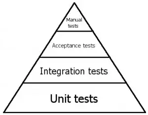

It is important to keep the testing triangle in mind when creating tests:
alt text
This means you should create many more tests at the lower levels of the triangle, and spend less time higher up. It is more costly to maintain end-to-end tests than unit tests.

    +1 for the triangle, but I haven't seen much information about BDD specifically. Given that BDD is *Behavior* driven development, I would expect such tests to be higher up on the triangle. – Robert Harvey Jan 23 '11 at 18:22
