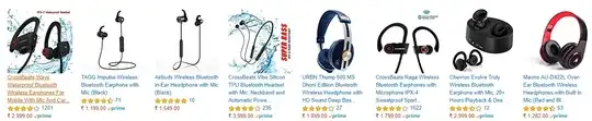

Next section is of "Similar products" which shows basic details of multiple similar products. This section is similar to Amazon's "Sponsored products" section.
Now as per our current approach, we first invoke "Recommend" service which returns list of product ids. Then we send these ids to all other micro-services to fetch their product details, prices, offers & image.
