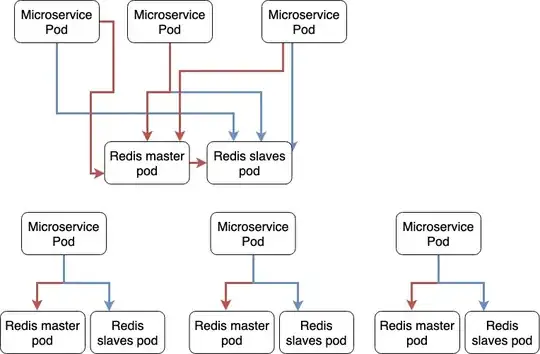

Say that we have Kubernetes running with n pods, each being a separate microservice. Now, some of those services need a caching layer. When we take into consideration:
  • the fact that Redis was tested to hundred of millions of keys and that it was performant
  • the fact that you can tag keys by namespaces (which would be microservice names in this instance)
  • the fact that the data would have a relatively short expiration time (we'd hardly hit the number of 10M+ keys at a given moment)
  • the fact that we have a single (although replicated) database from which data is fetched. PS: I know this goes against reactive principles. (Thanks to Ewan for reminding me to add this)
Would we spin up separate Redis pods, each corresponding to a single service or would a single Redis master pod with a separate pod for slave containers be a better architectural choice? Would having separate Redis pods be an antipattern of some sort?
A diagram to help you visualize the dilemma:

If we consider the cache to be orthogonal to the architecture (and it's), the first pic is ok.
For the same reason that we don't deploy one security service, one API gateway, one message broker or one service locator per POD we don't have to deploy one Cache (in replica-set) per POD.1,2
Be aware of premature optimizations
Caches are meant to solve specific performance issues. Mainly those derived from costly IPCs or heavy calculations. Without evidence of any of these issues, deploying caches (in replica-set) per POD for the sake of the "MS' God", is premature optimization (among other things).

Separate services should use separate REDIS instances.
Reason: Bad usage of REDIS by another service, causing REDIS outage, should not impact your application.
Only queues which are used for inter-service communication should be shared.

  • But is resiliency really a factor here as Redis is configured with a master-slave replication, plus those slaves are replicated through multiple containers in a pod as shown above? – Milan Velebit Mar 19 '19 at 13:49
    Lets zoom it out - consider 2 different microservices as 2 different companies altogether. Now would you allow a aws hosted redis service to be shared with other companies service ? – Sahil Gupta Mar 20 '19 at 02:17
    IMHO As long those microservices are delovepped by the same team it is fine. Furthermore we don't have the whole picture of how those microservices are used all together, they might have no value if one is down aniway. If it was handled by different cmopany I would however consider definitively to split up the architecture. – Walfrat Mar 20 '19 at 08:26
Can you prevent that one service writes into the namespace of another service? If not, sharing one Redis instance breaks service separation. And soon Redis will be used as a way to sync data. Not to mention the risk that one service accidentally manipulates another service's data.
If you can enforce the separate namespaces via Redis, i.e. different access credentials with access only to their own namespace like it's possible in most SQL database servers, then sharing would be fine IF you accept having one redundancy bottleneck for all services.

    @MilanVelebit I get your "pragmatism", and if you decide it's okay for you, well, your decision. But it's one more step in the "wrong" direction (reminds me a bit of the broken window theory). One big advantage of proper microservice design is exactly that it prevents any such "huge" issues and "misuse" of such central components to creep in until they are hard to untangle. I've never bought that it *needs* to be like this, you can also enforce modularisation in a monolith after all, but if you go with services, it's a sane way and what many expect to see. In any case, your decision. – Frank Hopkins Mar 19 '19 at 21:25
  • Fully agree, and yeah this reeks of a microlithic design.. :/ – Milan Velebit Mar 19 '19 at 21:54
    While I agree with the thing about central things, I don't think cache is one of these. In this specific case, moving from one cache to dedícated one has no impact. It would be moving the calls from one DNS to another. There's nothing coupling because cache is not a backbone. It's not a ESB or anything similiar. If it's used as cache, there's nothing wrong with having one single provider who at the same time scale out/up independently from the rest. – Laiv Mar 20 '19 at 06:27
