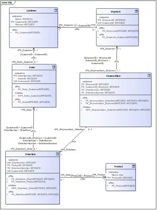

From the question I assume that the model looks essentially like this: enter image description here
To my surprise I managed to create a database (MySql, see DDL below, and please verify!) that propagated the CustomerID via forein keys into the shipmentItem (attribute Customer_ID_Shipment). My surprise was that this attribute can be used in both the FK to OrderItem (where it is the CustomerID of the Order) as in the FK to Shipment (where it is the CustomeID of Shipment).
However I would not do it that way: I am sure that the IT-system where the problem arises has a reasonable architecture meaning that there will be one piece (or very few pieces) of logic responsible for the "SQL insert" and the "SQL update" (e.g. in OO exactly one class "shipment"). I would simply code the necessary constraint there – typically there are other business rules that are difficult to express and maintain in SQL and easy in "code".
Here is the DDL:

Übend
  • here some data: insert into Customer values("Client33", 33, 3333); insert into Shipment values(22, 33); insert into Product values ("P66", 66); insert into customdb.Order values (4,4,33); insert into customdb.Order values (4,4,32); ## should fail insert into OrderItem values (4,66,1,33); insert into ShipmentItem values (22,33,4,1); – Übend Nov 24 '19 at 10:34

@Übend 's solution works, but it's complex to understand and explain, perhaps because of the fact that an order's uniqueness should be provided solely by the order id. Let me explain, if the unique identifier of the Orders table is (OrderID,CustomerID) it means that potentially there could be two orders with the same OrderID as long as the CustomerID is not the same. It doesn't sound quite right to me. CustomerID should be just a FK pointing to Orders.
