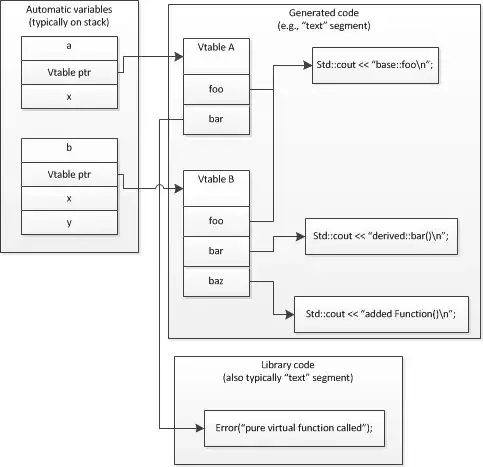

As to how this is done: at least in C++, it's normally done using a vtable. When you invoke a member function, your function receives a hidden parameter named this. If the class defines (non-static) member variables, those variables are accessed by taking an offset from the address in the this pointer--i.e., a pointer to the data storage for the object. If the class contains at least one virtual function, the object will also contain a (hidden) pointer to a vtable for that class. So let's consider code like this:

This will typically be laid out in memory something like this:
So, when we invoke member function, it receives this as a hidden parameter. That points to the a or b object in memory. When we invoke a virtual member function, the compiler generates code to get the correct offset in that object for the vtable pointer. Then it dereferences the vtable pointer to get the vtable for the type of object being referenced. Finally, it looks at a specified offset in the vtable to get to the correct function being invoked.
