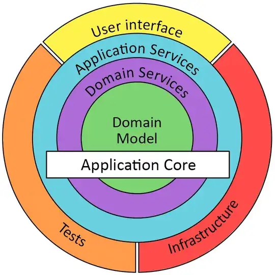

Many of these other terms aren't from Clean Architecture either. They are from Onion Architecture.
Here I mind the conflation much less because as Uncle Bob has admitted Clean Architecture explicitly lifts many of it's ideas and structure from Onion Architecture (which does the same from Hex / Ports and Adapters). It's all much the same idea with different buzz words that drive you to different blogs & books.
So as you were saying:
Presentation layer and the Domain Model layer are separated by the Application layer.
Yes, if by "domain" you mean Clean Architecture's Entities and by "Application layer" you mean Clean's Application Business Rules (Use Cases) and not OSIs Application layer.
Just be aware some people may map Onions domain onto both Cleans Entities and Use Cases. That doesn't mean separation logic isn't still a good idea. We're literally arguing semantics here.
So I'd say your assumption is correct. If I'm decoding your meaning correctly.

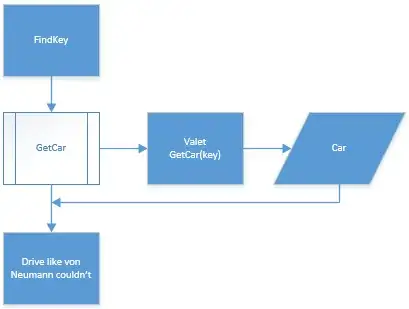

And that brings me to output ports. One of the nifty things about Clean Architecture plugins is that despite everything being nicely a-cyclic, which keeps source code changes from propagating through your code base, you can still send the flow of control anywhere!
That works because of this little trick:
That open arrow head between Presenter and Use Case Output Port is asking for some kind of polymorphism. As long as you can provide that you can let info flow to anywhere you need it to and still ensure your architecture is a-cyclic.
