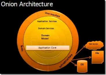

Onion architecture has a core which is composed by domain model, domain services and application services:
Onion architecture
I'm in doubt about those two service layers, domain services and application services.
I've been reading that they're related to DDD but I'm not familiar with DDD myself.
I'm not asking for the relationship, just an explanation of what those two layers do, and if possible a simple example in Java.
I've read that Domain Services are services used by the domain model and Application Services are services made accessible to the outer layers. Is this correct?
So a Repository would be a Domain Service and Application Services are related to the Use Cases of the application.
All of that is still unclear to me.

Answer to your question
Taking Jeff Palermo's own explanations:
  • Domain Services: it is interfaces who are implemented in the outer layers, since they need some services of the outer world (i.e. databases).
    The first layer around the Domain Model is typically where we would find interfaces that provide object saving and retrieving behavior, called repository interfaces. The object saving behavior is not in the application core, however, because it typically involves a database. Only the interface is in the application core.
  • Application Services: it is the application logic, that doesn't depend on the interfaces to the outside world (so independent of the user interface as well).
    The code that interacts with the database will implement interfaces in the application core. The application core is coupled to those interfaces but not the actual data access code. In this way, we can change code in any outer layer without affecting the application core.
So this architecture is about dependencies and abstractions, for example:
  • in the inner circle, you'll have IConference, an abstraction of the domain object.
  • in the domain services, you'll have IConferenceRepository that will allows you to retrieve and save IConferences.
  • in the application services, you'll have things like booking of conferences by users. THe application service depends then only on IConference, IConferenceRepository, IUser and IUserRepository. This ensures that application code still compiles, whatever the real implementation of the interfaces will be.
  • in the outer layers, you'll have the concrete implementation of ConferenceRepository that would then use a concrete database to do its job.
