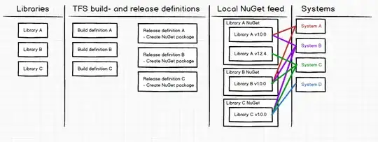

As mentioned, some of us thought this through and came up with a solution using TFS to automaticaly create a NuGet package in our local NuGet feed, and then we can simply update said NuGet package to include the new functionality across multiple systems.
Here's a simple illustration to show our ideas:
Of course we would write tests for our shared libraries, but we can be sure that they're working and we do not need to write the same functionality into multiple systems, since they'd just use the library we created for this specific scenario.
Should it occur that we add breaking functionality, the existing systems would not need to update their NuGet package, unless they need that new functionality. It would be okay for System A and System B to still use Library A v1.0.0 though we just added new functionality to Library A v.1.2.4. Should it occur that the existing systems would need new functionality based on one of the libraries, and we did add breaking functionality, it's just a matter of rewriting the old code, to accept the new changes.
I gather this is the contentious issue, not that legacy apps wouldn't be immediately updated, but that a new system would pick a version based on required functionality.
I would say that although its common not to keep up to date with the latest package releases, its bad practice to not use the latest version of a library when you are adding it for the first time.
There is a difference between 'versions' and 'supported versions'. If you found a bug in say v1.0.0.0 of your library after you had released v2.0.0.0, you would only release a hot fixed version v1.0.1.0 if v1 was a 'supported version'. Otherwise you would just release v2.0.1.0 and advise your users to upgrade to v2
If you treat every version as a supported version that's a lot of overhead to deal with.

  • I agree with the fact that it's bad practice not to use the latest version when creating a new system that should use the functionality of said library, and I agree that hot fixes for v.1.0.0 should not only be fixed in v.2.0.0, but we should create a hotfix for version 1, like v.1.0.1, if v.1 is a supported version. – Detilium Jan 30 '19 at 09:21
  • yeah, I guess the question boils down to, do you want to be making v1 a supported version? – Ewan Jan 30 '19 at 09:23
  • Exactly, that's something we'll have to consider further down the road, when we suddenly have many version of the same library. But I'm more interested in the base idea of this architecture. Is it viable or do we end up with loads of issues when we have many shared libraries? I can't see any issues with this architecture. – Detilium Jan 30 '19 at 09:28
  • well there's nothing wrong with using nuget, as you have established by using it for public libraries. the odd thing about your setup is the idea of deliberately not using the latest version. – Ewan Jan 30 '19 at 09:30
  • We will be using the latest library in new systems, but I cannot see any reasons for going back into existing systems that use the library, before we actually need the new functionality, or scenarios where we need to edit the existing system anyways. I just don't want to go through each system using the library, everytime I add a new version of the library. I only want to update the library verion in a system, whenever I need to make other changes to said system anyways. – Detilium Jan 30 '19 at 09:33
  • well, if you don't update the library you don't get bug fixes. but no-one is putting a gun to your head or anything – Ewan Jan 30 '19 at 09:40
