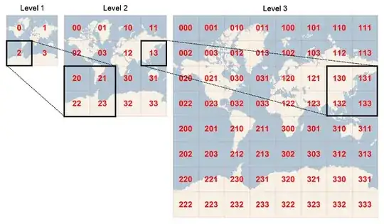

An approach to this is to use Geohashes as a way of encoding locations.
Subdividing a space
This encoding technique subdivides a space into squares and assigns each of those squares an alphanumeric code.
Subdivide each square again and do the same and keep recursing down to the point that you can resolve the longitude / latitude of the location in question to the desired level of accuracy.
You then end up with a Geohash for the location similar to gbsuv7zt and that is effectively an encoding of the location in ascending accuracy from left to right.
The centre of the map and the zoom level can then be encoded as a geohash too and you can compare hashes by the amount of matching leading characters. Location gbsut7zt matches the first 4 characters and means it is relatively close.
There are some edge cases where locations sit just outside the enclosing box of a geohash, and that requires looking in the neighbouring squares to find nearby results.
Code approach (image from https://www.joinc.co.kr)
