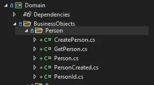

In this solution Commands, Queries, and Event dispatching is core to the Domain so understanding Mediator is fundamental to working out of it. The "Domain Mediator" implementation is less of a dependency on a particular class, but more of a dependency on the Domain.
Using this approach we avoid duplicate Commands, Queries and Events. We also get the benefit of knowing all of the functions of a domain object by quickly looking at its folder. Its self-describing.
Since we're using IMediator, all commands, queries, and events use an interface that is easily testable (IRequest, INotification) and most importantly, abstract. This abstraction allows us to write our business logic abstraction in the domain, while the implementation can be executed in the outer layers (Application/Infrastructure). This follows clean architecture design principles.

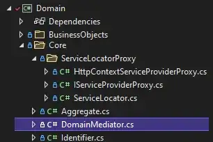

Here is how to setup the Domain Mediator static class with Service locator
