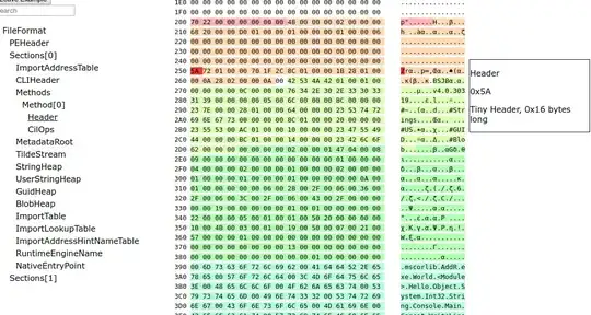

Other answers have described viewing a hex dump, or writing out object structures in i.e. JSON. I think combining both of these is very helpful.
Using a tool that can render the JSON on top of the hex dump is really useful; I wrote an open source tool that parsed .NET binaries called dotNetBytes, here's a view of an example DLL.
dotNetBytes Example
