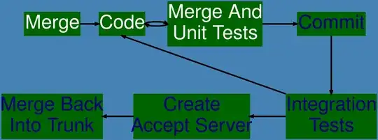

I have to define the new way of working for a development team which goes from a one man unit, to a distributed team with programmers al over the world. The team will work with svn. This is a non-negotiable thing. I recommended that they switch from svn to git, but that is not going to happen. This is the first time I do something like this. At the moment I think about something like:
enter image description here White text are things that are done manually. Blue text are things that are done automatically.
  • Every developer has his own branch and does his development on this branch. (This is my preferred way and in my research I saw this also recommended. But I also saw often that svn users did not like to do this. Especially on the long term I think this would bear more fruit. Or am I overestimating the difference?)
  • At least every morning before a developer starts working he merges trunk into his branch.
  • Normal work should be checked in the same days as it is started. For work that takes longer a special branch should be created. This branch should also have trunk merged into it at least at the start of the workday.
  • Every-time the developer has added something that can be tested, he should run the unit tests. Before running the unit tests an automatic merge is done. If this results in conflicts those have to be solved.
  • When the developer thinks he has something that can be committed he calls the unit tests with a commit flag. When everything is OK the commit and follow-up actions are executed.
  • A pre-hook is defined that checks that the merge and unit tests where successful.
  • After the commit is done successfully a post-hook will create an integration server where the above tests are run again and integration tests are performed. When it is not a special branch: on success an acceptation server is created with this branch and the branch is merged (--reintegrate) into trunk. The developer is always notified of the result.
  • A developer is only allowed to go home when his version is successfully committed. Ideally it should also pass the integration tests. (This sounds a bit harsh, but I added this because I have seen developers not committing for weeks because they had not changed much yet. With all the merge problems this created.)
Because it is important to minimise things that can go wrong (people that would give help when there is a problem probably sleep at the moment it is needed, so it should be minimised at 'all costs'), I am thinking about locking svn trunk before the commit and releasing after the automatic steps are done. In this way it should be nearly impossible that the 'Merge Back Into Trunk' goes wrong. The idea is that the tests are reasonable fast and it is better to wait a little before the commits are done, then that there is a chance that the automatic part goes wrong.
Is this an acceptable way of working?
If so: can this be done with svn?
More about the way of working I am thinking about.

  • I miss the point of your idea of locking the SVN server - if I got your process right, when a "Merge back into trunk" fails, noone else except the person who tried it does not get his/her code integrated, so noone else is directly affected. – Doc Brown Jan 08 '19 at 14:12
  • @DocBrown The idea was that when two developers would commit at almost the same time, it would be possible that both individually pass the integration test, but combined do not and that by locking only one could commit and you would not get this situation without the second developer getting a long delay. But the way of working has changed: now there is always a review. So with this new workflow (which I prefer) I do not think it opportune to do it like this any-more. – Cecil Westerhof Jan 08 '19 at 15:00
  • @DocBrown In hindsight I think I was to careful. Probably there will be at most 10 developers. When they are spread over the globe then is the chance the will get into each-other way slim I think. But better to careful, as not careful enough. ;-) – Cecil Westerhof Jan 08 '19 at 15:29
  • @CecilWesterhof: what you described would not end in a failed "merge into trunk", but in a failing integration test after a successful merge, right? However, I think the process above approaches this from the wrong angle. In those rare case you have conflicting changes which make it into the trunk, on each side of the globe there should be someone able to fix the problems. That is the idea of "shared code ownership". Reviews, especially cross-site reviews, will help to get the team to that point, of course. – Doc Brown Jan 08 '19 at 15:35
  • _"Every developer has his own branch and does his development on this branch."_ Just to be clear, are you advocating a branch per _developer_, or per _change/feature_ (which generally is assigned to a given developer)? If I, as a developer, finish my task and start another, do I create a new branch or do I repurpose "my" branch from the first task? – Flater Jan 15 '20 at 08:55
In the way of working you describe, there is very little advantage to using branches. With all the merging back and forth, you might as well be working directly on Trunk, except in the (hopefully rare) case that your commit breaks the integration tests. Note that every developer always has a private, local working environment that can be regarded as a kind of branch as well.
Although working with a single (trunk/develop) branch is common in SVN, you can also use the branch-based strategies that are more common among GIT users. Only strategies that depend on (or assume) a distributed VCS are not usable with SVN.
My recommendation would be to let go of the separate branch for each developer and let them work on Trunk for small changes. SVN will enforce that all required merges are performed before they can commit. For larger features, a separate branch can still be useful to isolate the other team members from the ongoing unfinished work.
Each commit (to Trunk) should still trigger a run of the CI tests and there should be an agreement that no new commits will be made as long as the CI system reports problems (with the exception for commits to resolve the problem).

  • Thanks for the answer. I got something to think about. ;-) The reasons for the different branches is that I want to be sure that the version on trunk is always a correct version. Especially because all the new programmers will be new to the system. So I am afraid that breaking the integration tests would not be rare. – Cecil Westerhof Jan 07 '19 at 10:34
  • No new commits is completely agreement based? That looks like an accident waiting to happen. Or can it be enforced? – Cecil Westerhof Jan 07 '19 at 10:37
    @LazyBadger: Then why is there a growing trend to stop using feature branches and only use the develop branch? – Bart van Ingen Schenau Jan 07 '19 at 10:50
    @CecilWesterhof: The "no new commits" can not be enforced by tooling, because tooling can't tell if a commit introduces new functionality or if it fixes a bug introduced by the previous commit. If you think a trunk-based strategy isn't right for your team, then I would recommend a feature-branch based strategy (so a new branch for each feature/ticket) – Bart van Ingen Schenau Jan 07 '19 at 10:54
  • I thought it could not be enforced, but just wanted to be sure. You know what they say about assume. I have to think about the branching strategy and also await the reaction on the recommendation I gave. – Cecil Westerhof Jan 07 '19 at 11:00

  • One reason for a branch pro developer is that for every developer there are three machines: a developer machine, an integration server and an accept server. The idea is that the last two machines are build using the developers branch. – Cecil Westerhof Jan 08 '19 at 12:16
  • Working off the trunk causes few problems for simple changes, provided that developers are disciplined enough to check that what they are checking in actually works. And even if it doesn't, it's not the end of the World - just fix it and check it in again. We only use branches for bigger stuff - exploring new ideas or porting to new platforms. – Simon B Jan 08 '19 at 16:00
