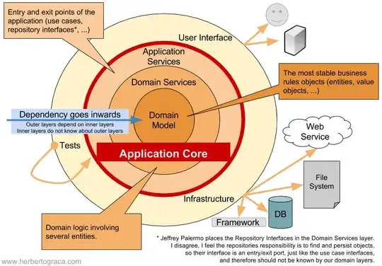

In simple words as I understood your problem... you have lots of internal services and then you have another external service which is being used to interact\calling all of these internal services.
In world of Onion Architecture we call internal services domain services and external services as application services. As shown in picture below,
Its always a bad practice to make calls to all internal services from a single external service.
The concept to take is that, external\application services are not bad as far as they logically make sense and not just a dump station for everything.
In case your domain services depend on each other, you can extract them into a third service naming it properly and put shared methods in them.
