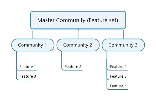

The solution will have one master application which will just serve as master list of features for admin to enable features while creating new community. Multiple communities having separate databases, each community has multiple features (Feature1, Feature2). There should be a way for developers to forward integrate and backward integrate the features.
After adding the feature to any community, It can have its own customizations in particular feature. In some scenarios developers also need to add these changes to the master or the sibling communities. I also have added the Image for better understanding.
Architecture Image
I need help in creating the Branching Strategy for my solution that fulfils all above requirements and minimize the chances of conflicts while merging the branches all across. I have below options in my mind.

Keep it simple for yourself. Just put all "communities" in a single branch.
In most development methodologies, feature branches are created to isolate the development of a feature; once the feature is completed, it should be merged to the master branch, and they become part of the base application. Feature branches isn't intended to isolate different configurations of an application.
Add feature flags to the application, use strategy patterns to provide different behaviour for different configurations.
This way, you don't need to rebuild applications multiple times for each community, everyone uses the same exact executables, with the differences described in high level in a set of configuration files.
If your community configuration is complex, you may want to version the configuration files as well, but these configuration files should be versioned in a separate repository than the base application. You probably want to create one repository for each "community", or alternatively they could be different git roots in the same repository, you're unlikely to need to want to share configurations between "communities", so you might want to avoid merging between different community roots. Another alternative is to create a single-family branch with all communities as folders, this should be done with caution, as it may be difficult to split the configurations for a single "community" without losing git history, as their histories will be intertwined with other "communities".
