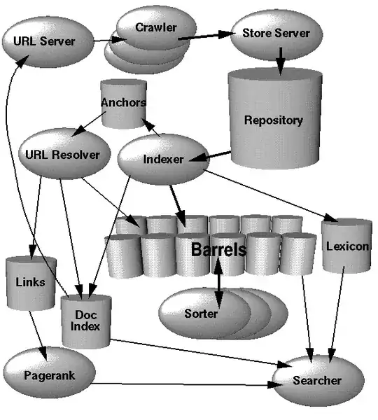

The post on Quora yielded the original article published by Sergey Brin and Larry Page. It seems to be an excellent reference for this type of question.
Google Architecture
