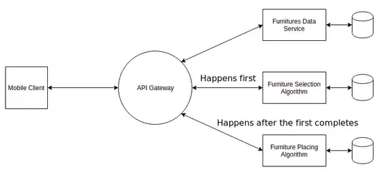

One of the most important tasks of the system is to perform the furniture selection and furniture placement algorithms (as shown below). The selection takes place first and provides the output to the placement algorithm which should give the result to the user.
Once the API Gateway has the request, I have 2 options:
  1. The API Gateway sends a request to Selection Algorithm Service. Waits for its response. Once the API Gateway receives the response, it sends a request (along with the response received from the previous request) to the Placement Algorithm Service. Gets the response and returns it to the client. Illustration below:

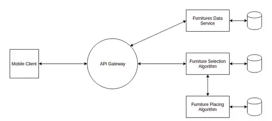

  1. The API Gateway sends a request to the Selection Algorithm Service which does the required processing and then sends a request to the Placement Algorithm Service along with the result. Once Placement Algorithm Service completes, it responds back to the Selection Algorithm which sends the response back to the API Gateway and the API Gateway returns it to the client. Illustration below:

In the case of your updated use case, I would restructure your options depending on what other uses of those microservices exist. In no case that I can presently think of would I have the Selection microservice directly call the Placement microservice.
Instead, I would either compose the work in the API Gateway as you described, or consolidate the microservices into a single component.
Providing a unified, higher-level API that manages multiple service call upstream is well within their scope, imo. The main reason you might not want to do this is if there are technical limits to doing so, for example if there are a lot of chatty calls between the two microservices that need to happen to resolve one client request. That might be the case for example, if you wanted to provide a client service that optimizes "best fit" analysis, both of selecting the furniture and placing it and in doing so you need to select a piece and place it in many combinations. If that's the case, I'd consider making one "Room Design" microservice that handles all that internally, which may let you optimize the database and queries better and so on.

    No, I'm saying that not everything needs to be the smallest possible microservice. Microservices should be logical chunks of work, which might mean that they do more than one thing under the hood (in your programming language of choice). If nothing else talks to the Furniture Placement service except the Furniture Selection service, then you don't need them to both be web-accessible services. Even if other things need to talk to both, it might make more sense to expose them as different API calls on the same service. – Paul Dec 05 '18 at 19:59
    This is the how I'm planning on solving the issue. Have one service called Room Design which contains two packages or libraries - Furniture Selection and Furniture Placement. This way they're still separate packages and can be independently developed but can also be put together using the Room Design Microservices – Shahlin Ibrahim Dec 06 '18 at 06:03
