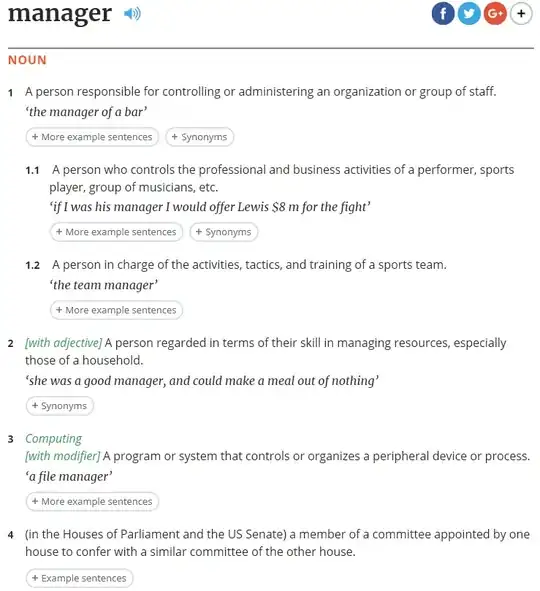

The word "manager" is not very descriptive. Looking up "manager" in the Oxford dictionary gives you 4 different definitions, and two sub-definitions:
Screenshot of the definition of the word manager in the Oxford dictionary
Without this becoming an English lesson, the main point is the word "manager" just isn't specific enough for other programmers to infer what a class does by its name.
Jeff Atwood expands on this in I Shall Call It.. SomethingManager:
This imprecision makes Manager a bad word to use in naming classes. For instance, take a class named UrlManager – you cannot tell whether it pool URLs, manipulates URLs or audits the use of them. All the name tells you is that this class does something with URLs. On the other hand, the name UrlBuilder provides a much clearer picture of what the class does.
So it all comes down to one of the hardest things in computer science: naming things — and SomethingManager is not a descriptive name.
