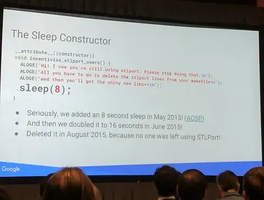

Ideally, you would want to wait until no one is using the deprecated method anymore. Considering you're using a public API, that's easy to track, but you might end up waiting a very long time.
in 2015, Google had a similar issue with the stlport API on their Android OS. They had deprecated it and wanted to remove it, but tons of apps were still using it. They found a clever solution:
Essentially, they added an 8 second sleep() during the bootup of any app which still used the API with an appropriate log message for the developers. A month later, they doubled it to 16 seconds. then another month later, they could safely remove the API interface because no one was left using it.
This can be a very effective way of doing this. The only real issue is if your API is very old and has actively used consumers that are no longer actively supported. Unfortunately, you probably won't be able to fix such consumers yourself, but at that point you can't really do much more than delete the method and break the consumer.
