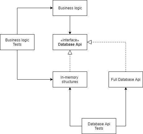

I really like to use combination of fakes and tests that work against both real and fake implementation. This is useful in case of faking database or other APIs.
This is how testing against DB api would look like: enter image description here
In this scenario some business logic needs some database. What it needs of database is in Database Api. The business logic tests test the business logic alongside fake in-memory database, possibly just lists of structures. This allows the business logic tests to be fast and isolated, even when there is many of them. Second set is Database Api tests. This set, runs same tests twice, once against the fake implementaion and second against real production implementation. This ensures that behavior of the two implementations is the same. Of course the real implementation will persist the data properly, while in-memory will be just local to single use-case.
Big advantage of this design is that business logic tests will run as fast unit tests, so there can be many of them and they can do complex logic without worrying about using slow, real implementation. While the Databse Api Tests can just test specific queries and not worry about the business logic.

  • This is an interesting partial case for domain/persistence layers. It surely accelerates some (many?) tests when in-memory and real database behave the same. If technique like this can be generalized to upper layers - would be perfect answer. – Roman Susi Oct 22 '18 at 19:13
    Well it **is** (IMO) the perfect answer, as it shows a very clean pattern that’s usable for any situation where mocking is needed, at any layer. Keep in mind that mocking isn’t all about speed, it’s also about isolation of failure. You don’t want your whole suite to fail because you broke something in your database class. Instead, only the database unit tests should fail. – Steve Chamaillard Oct 22 '18 at 21:15
    So, the answer is To have unit-tests backed with test double layer, which in it's own turn tested against same tests as the real layer? That is, basically having a mocked counterpart for all (or most important) interfaces? I think, this is acceptable answer then. – Roman Susi Oct 23 '18 at 03:28
