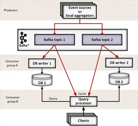

Offering events not yet written in the DB to clients
You want your clients to be able to get access also to information still in the pipe and not yet written to the DB. This is a little more delicate.
Option 1: Using a cache to complement db queries
I have not analysed in depth, but the first idea that comes to my mind would be to make the query processor(s) a consumer(s) of the kafka topics, but in a different kafka consumer group. The request processor would then receive all the messages that the DB writer will receive, but independently. It could then keep them in a local cache. The queries would then run on DB + cache (+ elimination of duplicates).
The design would then look like:
The scalability of this query layer could be achieved by adding more query processors (each in its own consumer group).
