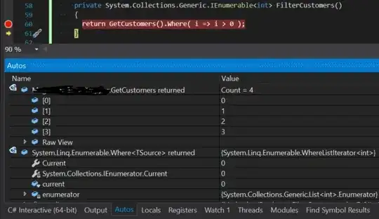

Since for both other answers the main advantage mentioned is 'for debugging' here's a tip: the debugger displays return values of functions, even nested ones, in both the Autos and Locals windows these days (accessible via Debug->Windows menu).
So if you put a breakpoint on the line return repository.GetCustomers.Where(x => x.IsActive); then do a single step (F10 usually), you'll get an entry with Name System.Linq.Enumerable.Where<TSource> returned in the watch windows where you can inspect the Value and Type just like any other variable. And in this case you'll also get an entry for what GetCustomers returned. Here's a screenshot for clarity:
tldr; if you've got the tooling there's really no need for using a variable. The alternative is clearer, shorter, can be used as Expression-bodied member.
