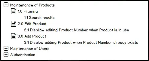

The documentation in this app/system contains about 400 use cases. We might have put more or less documentation into each use case than what you would. I suspect more.
I would like to be able to convert most of the documentation into end-to-end-tests. Right now we don't have any end-to-end or UI-tests. We have a lots of unit tests though. Imagine the following:
Fictional tree of use cases
The x.0 use cases are quite straight forward, but there are quite a few of the x.1 use cases - what we refer to as deviations from the happy path. When counting the 400 uses cases in our product, I didn't include all of the deviations.
I'd like to see a way where the documentation would be the test. Perhaps I could use something like the Gherkin syntax?
