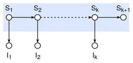

Here is a diagram illustrating the data flow. Information flows out of the encapsulated system (shaded background), and states only depend on previous states. This mutable state is easy to reason about.
hidden counter

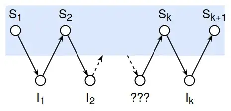

In contrast, “evil” global variables let data flow in multiple directions through the boundary of the encapsulated system. The state of the “encapsulated” system is shared among any consumers of that system, and the ID Ik depends on unknown inputs: we can get “action at a distance”, and multiple consumers (or simply, different parts of the code base) become more coupled. This data flow is much more difficult to reason about.
global variable
