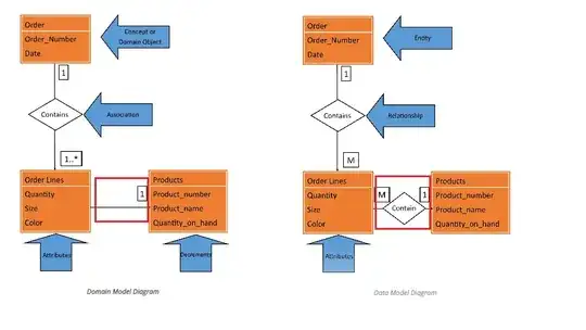

I've seen many articles describing differences between Domain Model and Data Model. However none of the articles have picture representations showing difference.
https://stackoverflow.com/questions/3507671/whats-the-difference-between-data-modelling-and-domain-modelling
Can someone provide a picture example showing difference, maybe a simple example with customers or orders, anything? I saw one example below from resource here, however the example difference seems very little (box in red) : https://study.com/academy/lesson/domain-model-vs-data-model.html
Can someone provide an example showing a larger difference between Domain and Data? This way readers can understand
Note: Seen article Why do 'some examples' and 'list of things' questions get closed? , yet have not read concise example on the internet showing Large differences between domain and data model, anything would help.

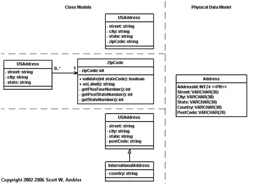

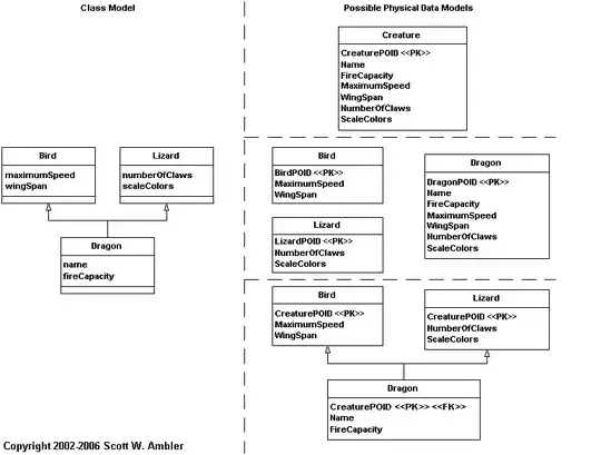

Brian Lawler's article Domain First vs Schema First Architecture might help.
Or Scott Wambler Why Data Models Shouldn't Drive Object Models
