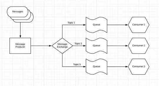

This is a very simple image of a setup where each consumer only cares about distinct topics for them: enter image description here

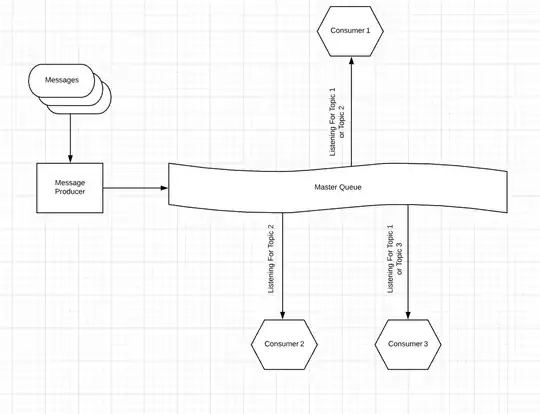

What I am envisioning instead is one huge message pipeline that all messages go through, with individual subscribers reading the messages relevant to them. Something closer to this concept:
My goal for this is to keep everything as loosely coupled as possible. With designs 1 or 2, we have to update the queueing system or exchange every time a new consumer gets added. With the third design, the queueing system is agnostic to what is consuming it, and instead just knows it needs to send messages. The consumers can then just read off the queue, grabbing copies of relevant messages to them.
Does this design make sense? We can't be the first ones to desire a system like this, as it should be a pretty common need (changes occur in a system, and multiple consumers need to act on them).

  • hmm no i think you will find that 'listen for a topic' means make a queue that is subscribed to that topic – Ewan Aug 17 '18 at 15:47
  • @Ewan wouldn't there need to be a queue then for each consumer of that topic? – Marshall Tigerus Aug 17 '18 at 18:31
  • no. what im saying is your consumers cant choose not to pull a message, or rather to do that they create a queue between them and the 'master queue' – Ewan Aug 17 '18 at 18:59
  • @Ewan that runs into the problem of the "master queue" having multiple readers for every message, which doesn't seem to be how it functions. – Marshall Tigerus Aug 17 '18 at 19:03
  • im not saying its good im saying your last diagram is impossible in rabbitMQ – Ewan Aug 17 '18 at 19:06
    ..or rather, that the realisation of diagram 3 in rabbitMQ is diagram 2 – Ewan Aug 17 '18 at 19:10
In the third diagram you are proposing, if Consumer 1 gets to the message first (and ACKS it), Consumers 2 and 3 will never receive it. If that is what you want then fine. If you want each Consumer to receive the message, then you need separate queue for each consumer.
The 3rd diagram is pretty much the scenario when you have multiple servers with the same consumer deployed. If Consumer 1 is deployed on 3 servers you don't care which servers gets to the message first.
To answer your concern, in diagram 1 and 2, your queuing system doesn't care about what queues are created. Or rather, your producer doesn't care because it's the consumer who should be creating and binding queues not the producer. The producer pushes a message with a routing key to an exchange. That's where its job ends. Then when you add a new consumer, it should create the queue and bind to the exchange with the routing key.

Typically the producer sticks the message onto a single queue that all consumers read from, with locking to ensure only one gets the message.
However, the 3rd scenario works brilliantly if all consumers receive the same message and decide whether they will process it or not. I've used that approach many times with great success, but you must have a way of differentiating which consumer will process the message and if you cannot, then all of them will. This may not be such a problem, for example a UI can use such a system and a message will be passed to all consumers (eg UI elements) that pass the criteria (eg they are under the mouse cursor when the event is raised)
So ultimately the answer here is "it depends" on what your messages are and how your consumers process them.
For further reading I'd look at the zeromq guide, they go into some detail about lots of different message queuing systems and the benefits/disadvantages of them.
