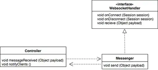

I am trying to resolve a circular dependency between two components in my system. The Messenger component is responsible for sending and receiving messages on a web socket. The Controller component requires use of the Messenger component to be able to send messages to connected clients because the Messenger component knows about the connected sessions.
The Messenger component has a dependency on the Controller component to be able notify the controller of incoming messages.
The WebsocketHandler is a framework interface that I have no control over in this case and calls the appropriate methods on my implementation based on the connected clients.
What architectural changes could I make to resolve this?
UML Diagram
interface WebsocketHandler
    void onConnect(Session session);
    void onDisconnect(Session session);
    void recieve(Object payload);
class Messenger implements WebsocketHandler
    Controller controller;
    Set<WebsocketSession> websocketSessions;
    @Override
        sessions.add(session);
    @Override
        sessions.remove(session);
    @Override
        controller.messageReceived(payload);
    // requires access to sessions to send messages
    void send(Object payload)
        for (WebsocketSession session : websocketSessions)
            session.send(payload);
class Controller
    Messenger messenger;
    void messageReceived(Object payload)
        // do something with payload
    void notifyClients()
        messenger.send(...);

The simple solution to this is to recognise that Controller doesn't need a dependency on Messenger, it needs a dependency on send. So provide it with that dependency:
interface Sender {
    void send(Object payload);
class Messenger implements WebsocketHandler, Sender { …
class Controller
    Sender sender;
        sender.send(...);
Now, Controller just has a dependency on the Sender interface, removing that circular dependency.
UPDATE
As the OP points out, the above removes the direct circular dependency between Controller and Messenger. However, if constructor injection is used, the dependency still exists at the point of creation of the objects: we need to create Sender first to satisfy Controller's need for a Sender, but we need to create Controller first as Messenger needs to call controller.messageReceived(payload).
There are various ways of working around this, such as supporting property injection. But my personally favourite, for languages that support functions as first class citizens is to fully decouple the two objects via functions.

  • This sounds great but what about the fact `Sender` needs access to the session held in `Messenger`. Would it make sense to extract them into some sort of session registry component? – Robert Hunt Aug 09 '18 at 19:10
  • @RobertHunt Which one? – Stop harming Monica Aug 09 '18 at 20:23
  • @Goyo the `Messenger` class currently stores a set of websocket sessions as clients connect and disconnect, for the `Sender` to send a message it needs access to these sessions. – Robert Hunt Aug 09 '18 at 21:35
    Yes, but knowledge of that session is not part of the Sender interface. Breaking Sender Method signatuure breaks the circular dependency between Messenger and Controller and abstracts away implementation details of sendini a message.Session is an implementation detail that happega to be necessart for Messenger that implementation the Sender. At some future point in time you might replace implementation of Sender with one that sends its messages to Kafka topic for example and Controller will not care a one bit. – Roland Tepp Aug 10 '18 at 05:17
  • @RobertHunt, I'm sorry, I don't understand your question. `Messenger` implements `Sender`. It is the sender. So why would `Sender` need to know about the sessions? That's an implementation detail of `Messenger`. – David Arno Aug 10 '18 at 06:40
    @DavidArno Sorry, I had missed the fact you had `Messenger` implementing the `Sender` interface, it makes sense now. – Robert Hunt Aug 10 '18 at 06:50
  • Maybe I'm misunderstanding things here, this solution resolves the circular dependencies at the code level but if I were to use a DI container to create these components such as Spring and use constructor injection it wouldn't physically be able to construct the components. To instantiate `Controller` I would still need to create a `Sender` (Messenger) but to create `Messenger` I need to create a `Controller`. Are these two different levels/concepts of "circular dependency", this post explains the same https://stackoverflow.com/questions/44029931/how-do-interfaces-solve-circular-dependencies – Robert Hunt Aug 10 '18 at 07:38
  • @RobertHunt, You are right: my basic solution just moves the circular dependency problem if constructor injection is used. I've updated my answer to address this point. – David Arno Aug 10 '18 at 09:23
