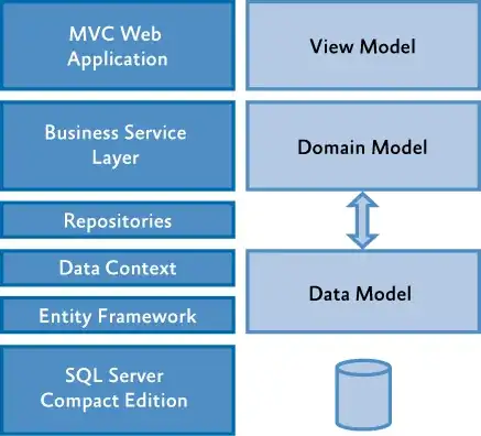

There are a lot of questions and answers about what a/the model is. Particularly when discussing where business logic belongs and the MVC pattern. There seem to be two concepts that need to be severed. I hope a question to this specific clarification has value.
The options are:
  1. A simple data carrier. No thinking except maybe some basic validation. (eg. POJOs/POCOs, View Models, classes mapped to database tables) (eg. here and here).
  2. An entire layer (or even group of layers) that comprise all business logic and data access (eg. here, here and here. A model can be almost anything).
The term model seems to have suffered beyond recovery. People are changing their architecture without realizing that the term is ambiguous.
Perhaps the perfect example of this ambiguity is Microsoft's architectural diagram of MVC: The MVC pattern is clearly located in the UI layer, but the concept of a model clearly spans every layer.
This is very confusing for both new comers and experienced software engineers.
I would like to point out that option 2 does not correspond in any way to the definitions of the word model. That does not help.
My questions are:
  1. Have I missed something important or does this accurately describe what has happened to the term model?
  2. Considering option 2 is unintuitive, don't we have better words for these different layers (like services, repositories, etc.)?

    Perhaps you should read the MS picture like: _left side_ shows the Layer where _Model_ mentioned on the right side lives. – Thomas Junk Aug 04 '18 at 17:06
    The dictionary definitions that you linked to are a bit generic; here is a better definition: https://en.wikipedia.org/wiki/Domain_model – Robert Harvey Aug 04 '18 at 20:34
  • I'm surprisingly pleased to see that Wikipedia's description of the Domain Model corresponds to Microsoft's architectural diagram above. The waters are slowly clearing for me. So that's what I should call the "domain model". Got it! I would still rather call it the (business) service layer and stop using the term model for everything. – MyiEye Aug 04 '18 at 20:44
    `I would still rather call it the (business) service layer and stop using the term model for everything` you didn't get it :-) Note that EVERYTHING is a model. As soon as a data structure provides with functionality and data to a domain problem is, in its own right, a model. No matter if it's related to your business or not. SMTP servers have their own models, message brokers, app containers, etc. Everything in software engineering happens within a bounded context. The one we call domain or business. The data structure that shape it is and will be always the model. – Laiv Aug 04 '18 at 21:05
    Make clear first the scope you are referring to. Then you can speak with no ambiguity about the data models, domain models, etc. What you call"service layer", "controller layer", "persitence layer" are just "scopes" and every scope might (should) have its own model. For the sake of decoupling – Laiv Aug 04 '18 at 21:08

One issue with these discussions is the all-to-frequent mixing of different architectural viewpoints in the same discussion or diagram.
  • Some architectural viewpoints are meant to show depth: deep dives into how some particular functionality is implemented.
  • Whereas other architectural viewpoints are intended to show breadth: the interactions of components that are peers (that exist at the same level in terms of depth).
Mixing both viewpoints (depth and breadth) together in the same diagram tends to lead to confusion.  In surveying the sources your citing, I find no shortage of this kind of mixing of these what would more ideally be separated architectural viewpoints.
For example, the diagram you're showing (citing Microsoft), you have said MS claims to be an MVC diagram, but it is primarily showing depth in the domain model, with overweight focus on persistence (from the MVC perspective). So, this diagram is weak on the breadth viewpoint of interacting peers (M,V,C) and mixes in some depth viewpoints with persistence: broken out (and elevated to be a peer of the other components).  It is understandable that one might question where the domain-logic belongs given the-all-to-easy-to-mix architectural viewpoints.
In MVC, the model is what is responsible for maintaining domain objects, responding to domain-oriented queries & commands (including validation, etc..), and enforcing/effecting domain-oriented rules & behaviors.  MVC doesn't speak to breaking out persistence: if your system includes persistence that is an implementation detail (detail of depth, not of breadth).  Thus, there is no question as to where domain-logic belongs in MVC, or whether domain-objects should be dumb or smart — these questions are all internal aspects (implementation details) of the model.
You are also correct that the term Model is overloaded and over used.  So, what the term means has to be evaluated in some context.  Unfortunately, many of these discussions fail to set or keep context, adding to confusion.
In MVC, the term Model means what I mentioned above (keeper of domain objects, handler of queries & commands..).  We might speak of POJO's, and such discussion should apply to the interactions between the peers M,V,C, and whether the query & command interface to the model uses dumber or smarter objects.
In detailing persistence — an implementation detail from the MVC perspective — we can speak to POJO's, or smart/dumb at different places in the persistence mechanism, we can even reuse the term model at different interfaces in the implementation details of persistence.
In summary, it is possible for the term model to be used in both ways you're describing — it is not either/or.  What makes things confusing is that we often fail to set context, and/or fail to show when we're shifting context from breadth (interacting of peer components) to depth (implementation detail of usually of one of these component).

  • Good insight. Can I summarize your answer regarding terminology as: "the term is indeed strongly ambiguous and we will simply have to learn to contextualize it for the rest of our lives"? Or are you saying that option 1 (eg. POJO's) is simply **part** of the option-2-model, which is ultimately the correct meaning? – MyiEye Aug 04 '18 at 17:54
  • Both in some sense. Regarding the former, yes, the term model is context sensitive. Regarding the latter, yes, though rather than describing the model as a layer, I would maybe call it a component of MVC; a component whose implementation detail isn't specified by MVC, but we can certainly talk about it by shifting to another context. – Erik Eidt Aug 04 '18 at 18:12
  • So would you say it's correct to label the combination of "view models" (for presentation), "domain models" (for business/domain logic) and "data models" (for performing persistence)" as **the model** of an application? – MyiEye Aug 04 '18 at 20:50
In MVC, the Model is anything that is not part of the View or the Controller. In MVVM, the Model is anything that is not part of the View or the ViewModel. That should be easy enough to remember.
If that definition doesn't satisfy you, then think of the Model as all of those components that relate directly to your problem domain, such as a Customer class or an Invoice class. Everything else is part of a UI abstraction, which is all MVC and MVVM really is.
In other words, MVC and MVVM really have nothing to say about the Model, from an architectural perspective. The structure and organization of the Model is entirely up to you; MVC and MVVM concern themselves primarily with the other components (view, view model, controller).
