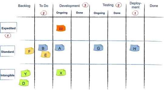

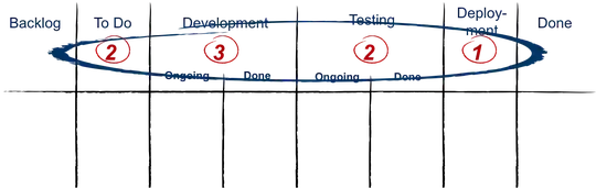

I am not sure you have quite precisely put your finger on exactly what the problem is, especially due to having taken on the new large customer. Are you starting to miss sprint goals/ deadlines? Are you seeing quality suffer? Are you seeing throughput/ velocity drop? Are you losing new prospective customers to competition because you are no longer working as much on your backlog tasks (which I assume are related to your roadmap)? What has changed, other than the fact that due to the new customer, your work mix has changed to more maintenance/ bug-fix type of work? And that you are concerned your lead time to fix issues might go up in the near future?
Having a large number of customers who are giving you feedback is a good thing! And not being able to - at least temporarily - work on your product roadmap is not a bad thing. Perhaps, this is the time to put your house in order, learn about and implement DevOps, get your test automation in place, reskill some of your team members.
Here, Kanban can help you in doing so. You don't have to give up Scrum, but use Kanban on top of that (Scrumban as many people call it), to help you improve and resolve issues. Kanban can help in several ways -
  1. It can help visualize your process - and work - on a Kanban board in more detail than is perhaps currently being done, to help you highlight which steps in your dev and deployment process might be the bottlenecks.
  1. It will start giving you data on your current performance to help you benchmark important metrics such as lead time and throughput and help you setup improvement goals. More about Kanban metrics here.
  1. If you are worried about increased lead time, due to too much work, Kanban recommends implementing WIP (work-in-progress) limits that you can implement at each stage of your workflow, to encourage your team members to finish what they already have on their plate before taking up the next work item. Limiting WIP will help you improve throughput and reduce cycle time.
  1. Kanban also gives you the ability to visualize and manage different types of work - customer work, backlog or roadmap work, technical debt, etc. - using different swimlanes on a Kanban board. That way, both the team as well as your stakeholders, get a full picture of just how much work there is across these different categories, that the team can take up when they have spare capacity. Kanban's "class of service" categorization of work into Expedited, Standard, Fixed Date and Intangible, helps everyone also understand what might be the cost of delay associated with each of the work items the team is expected to do, and perhaps discard stuff that has low or no cost of delay.
Given the complexity of your current situation, you could implement WIP limits both at column-level and for specific swim-lanes.
  1. Before you do any of this, you, of course, need a discussion - multiple discussions perhaps - with your dev teams and your stakeholders to understand what and where the problems are, and what you need to do to resolve them. These should help you come up with explicit policies - something else that the Kanban Method recommends - to deal with the backlog tasks vs. customer feedback, perhaps changing your sprints to every 2 weeks, and making a customer release only every 3 sprints, making capacity allocation to each type of work, taking a regular look at your overall backlog and prioritizing the top 5 or 10 items to be taken up next, etc.
There is no question that Kanban can help you analyze and improve your current dev management practices. You don't need to necessarily give up Scrum for that. If you'd like to learn more about Scrumban, you can look up here.
HTH - all the best!
